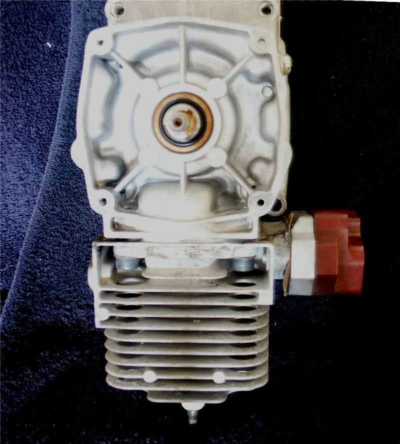

What you think, any experience converting Kawasaki's ? This one is a 40.2cc, Walboro rotating barrel carb. Came off a backpack blower. It's very tall, needs to be cut down & CDI ignition. It's only got fair compression, needs a set of Bowman rings. The piston & cylinder are smooth and clean.

After you cut off the lower portion, I see only two upper, as pictured, good mounting points...

If I use this side for mounting, I think I can use these four bolts for the mount. What you think ??

Good idea..Looks like an old TA51, heavy but indestructible..I converted a few many years ago...

The missing pic, that should work just fine. FWIW: I used hacksaw then dremel with cut-off wheel on that protruding shaft on Echo to allow flush mount.

I agree Mike, I had planned to cut the shaft off just a little out side the the seal to provide a flat mounting surface.
Any idea how powerful these engines are ? It "looks" like the finished product would be heavy, hard to guess. If these won't turn up pretty good RPM's and are boat anchors I won't mess with it. Any thoughts ???

I have one of these. I was told it was 36cc; never bothered to check. Let me know how yours turns out. Then maybe I'll dig mine out and give it a whirl. You might be able to cut the crankshaft off inside that seal, then block off where the seal was. Save a few ounces. Zagnut (I believe) has done this with the Kioritz engine he was working with. I'm going to do it to mine if/when I take it off the plane again.

Av8tor, Thanks for reminding me, that's how I did my Kioritz also. Guess I had a brain fade there for a while. I got 40.2 cc's from the "specs" on the original motor cover.

I decided that 40cc was a little bigger than I wanted to go so I did not convert them. Ended up giving them away to a friend who I'm sure will find a good use for them. Mabey he'll comment on his results.
