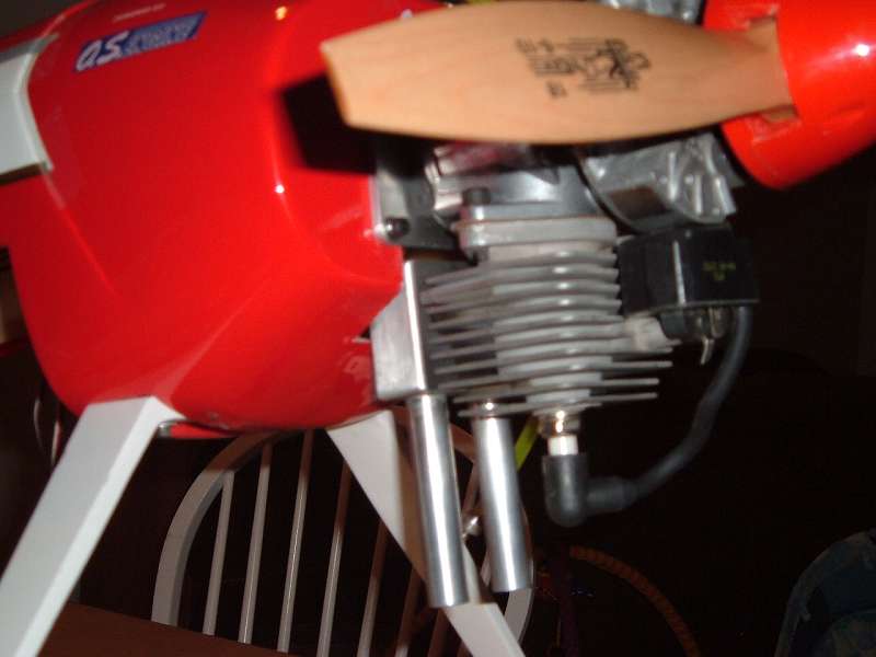

Hi! I am flying a Ryan's Rebel with a 31cc Ryobi, 18 x 6W APC prop and CH ignition, getting 8300 rpm's and can do just about everything you can think about (I am not good at Hovering but I am practicing) I fly at sea level; I use 87 octane fuel and mobil's MX2T oil at a 50:1 ratio, and having a ball with it, Here's a picture ob it when it had regular ignition.

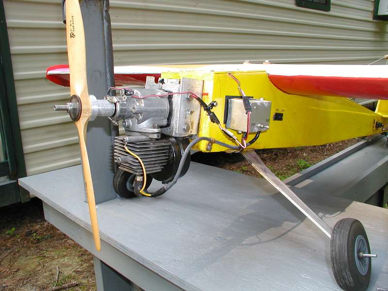

OK- I guess I will be different an list my plane (Not a Ryan Rebel)
I fly a 70" Sukhoi SU-31 It is a bit on the heavy side but it flies very well-

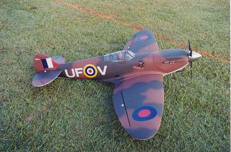

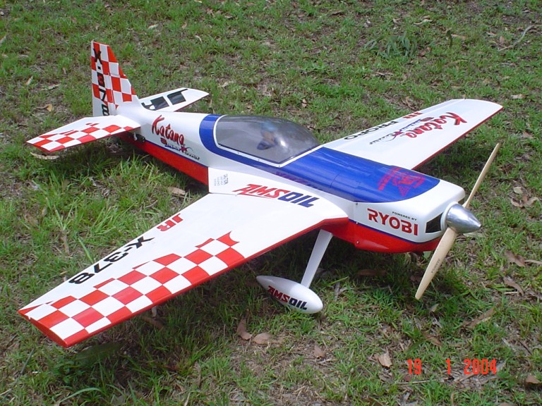

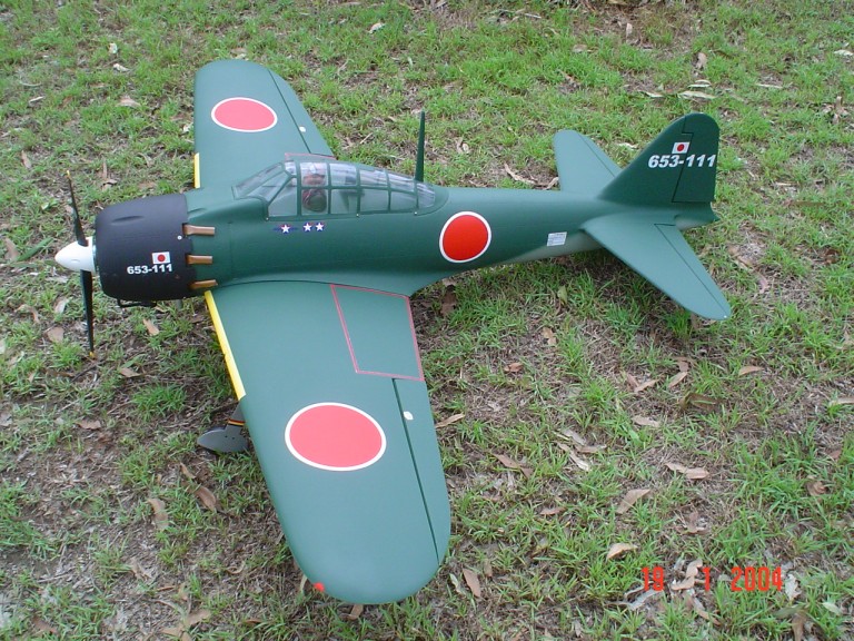

I'll be different again. 120 size warbirds are a great combo with this engine.
CM Pro Zero, CM Pro Spitfire, ESM Hurricane and I also have a CM Pro katana with a Ryobi.
Warbirds are all on magnetos and the Katana has a DA electronic ignition. Warbird engines
turn 16 * 10 3 blade MA's at 7600 rpm and the Katana turns an 18 * 8 bambula at 8000.
All great to fly. The Spitty and the Hurricane aren't mine but I put them together for friends.

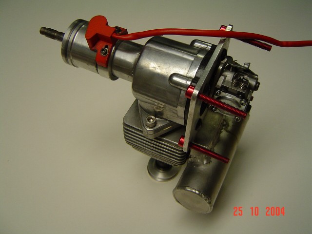

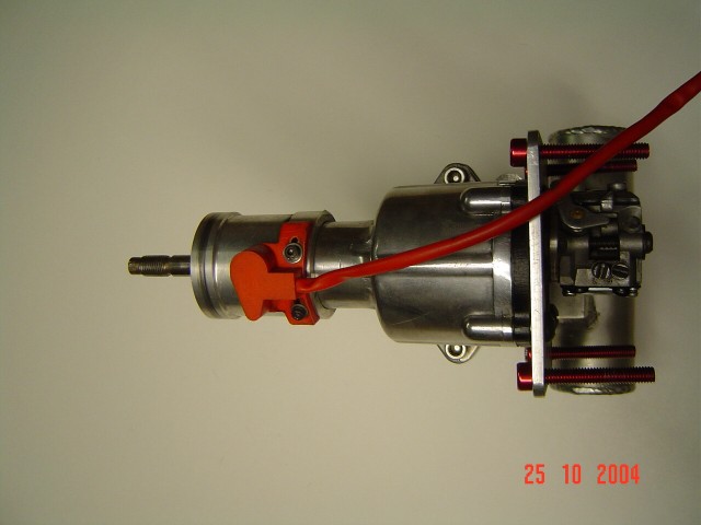

Do you have a photo of the 31cc Ryobi with DA ignition. Do you remove the flywheel? Thanks Capt,n

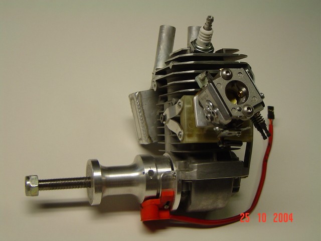

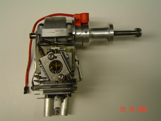

Capt'n,
Yep, remove the flywheel and anything else not needed. Make a hub with the pickup magnet and a ring to hold the pickup sensor and your away. The hub might look heavy in the pics but is has six 8mm holes drilled in a hex shape in the pickup side. Sorry pics don't include the ignition box. Can take one of that if you like. As you may know, DA ignitions are made Down Under and I happen to be a friend of the guy that makes them. Very SWEET. He is a great guy. Will help out in any way.
Have now converted Jonsered 40cc chainsaw engine with DA ignition and that going into the Katana. Should give it a boost. First two pics are of the Ryobi second two are the Jonsered for those not in the know.

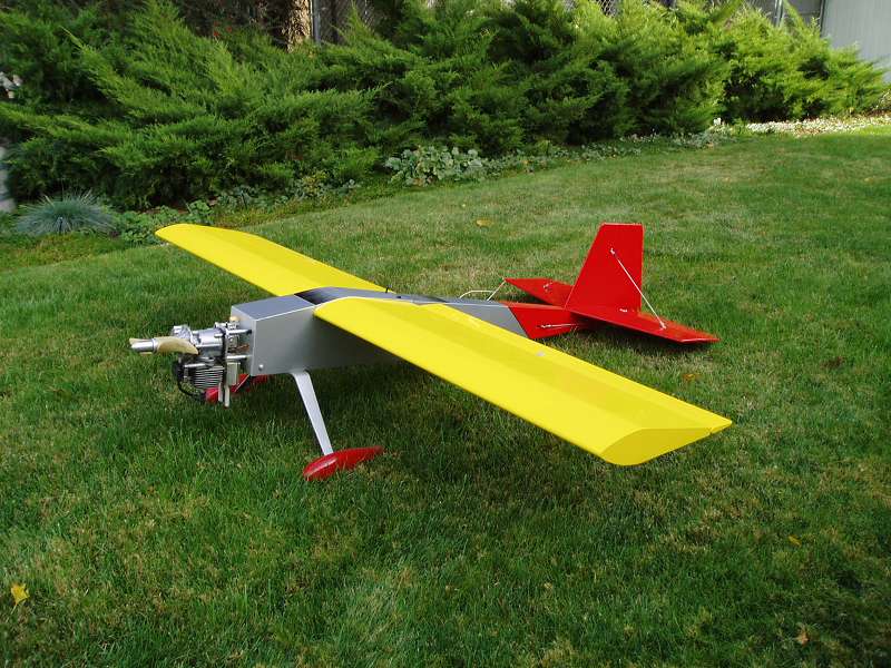

another"Rebel" Great flyer ! not 3-D But still great. Thank's Ryan

As shown in your first pic, what's the weight of the Ryobi 31cc (firewall foward) ?

Schpankme
Ryobi as in photo with muffler weighs 1320 grams or 46 1/2 ozs.
Jonsered as in photo with muffler weighs 1550 grams or 54 1/2 ozs.

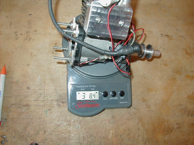

Schpankme, Those are very lite motors. I like to weigh mine as "ready to fly".
For instance my Homie 30 is 56.4 Oz. and that includes engine, muffler, ignition system, battery, switch, linkages prop nut and washer and whatever it takes to mount it. Everything except prop and spinner.

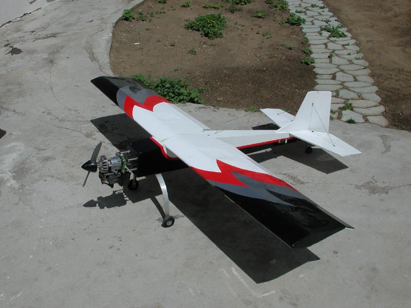

I am offering the Ryan's Rebel as a complete with engine ARF, ARF plane alone or ARC version, you can see it posted on the market place just go to airplanes > ARF and search for Item 67417, the price for an ARF complete with converted and mounted Ryobi 31 CC is $300.00 plus Shipping and Handling;
ARF plane alone $200.00 and ARC version $165.00 (plus shipping and handling avg. is about $45.00). These planes are custom covered in your choice of colors and personal scheme or you can choose from the ones I have already done, here are some pic's for you to see.
The plane's specs are the following:
Wing span 80 inches
Wing area 1200 sq inches
Weight ready to fly aprox 12-13 lbs
Wing loading about 25 oz/sqft
length about 63 inches
The fuselage is made out of lite ply, wings are two piece balsa sheeted foam core joined by an aluminum tube and the tail feathers are made out of balsa wood.

aero nut
The engine appears to be a cleverly mounted on stand off’s. Do you have any bigger pictures of the mounting?
