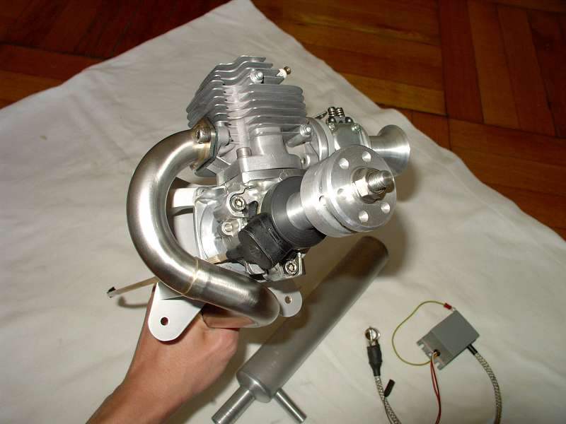

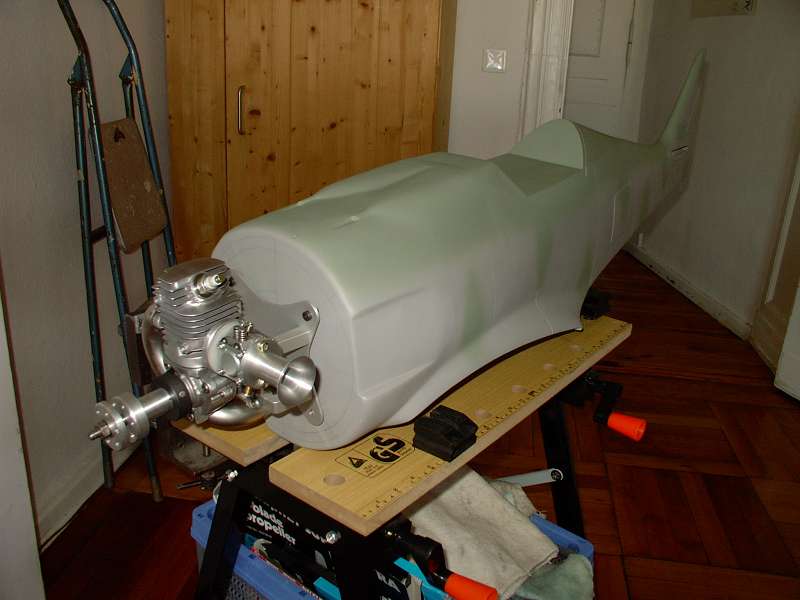

Old 04-24-2005 | 10:09 AM
Philipp Berlin's Avatar
Joined: Jan 2005
Posts: 8
From: Berlin, GERMANY
Default RE: Robin 24.5 cc conversion
Hi gsmith6879,
i use the same carb (WT 391), the adapter is "selfmade".
Now my system ist ready!
With this 25cm3 PEFA-Muffler it goes near 8000 RPM with the Graupner prop.
The engine, with a shorter venturi, fits perfect for my FW190A (1780 mm) ...
(Sorry for my english) []

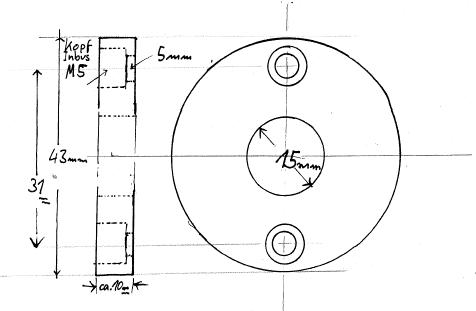

Old 04-25-2005 | 03:14 AM
Joined: Jan 2005
Posts: 8
Hello from Berlin,
thanks for the praise
The header ist from MTW (http://www.mtw-daempfer.de/html/hauptteil_krummer.html)
Look at the third foto on this site.
With an exact technical illustration with masses Mr. Weiershäuser
solders a header for under $ 40 (stainless steel). [sm=thumbup.gif] He is very helpful and fast. [sm=thumbup.gif]
The muffler is an older PEFA (http://www.pefa-modelltechnik.de/seite3.htm).
The insulator at the carburetor consists of two disks (aluminum and plastic) - very simple ...
Until later
Philipp

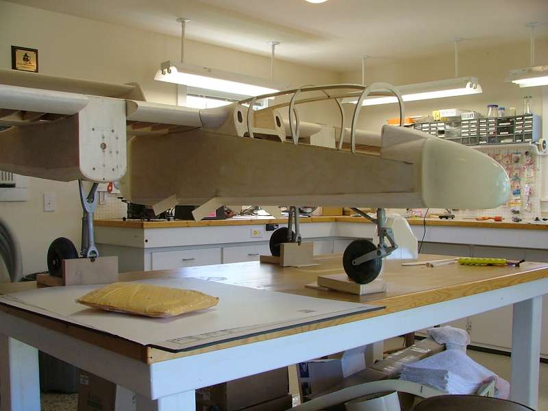

Old 04-30-2005 | 05:55 PM
My Feedback: (37)
Joined: Nov 2003
Posts: 553
From: Fort Gibson, OK
Phillipp,
Here are some photos of the OV10 construction and the conversion engine.
Gaines
