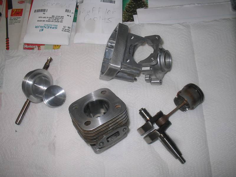

ORIGINAL: Wufnu
ORIGINAL: aero nut
Engine Weed eater 25 CC
Propeller APC 15x8
Glo Plug O.S. 4Stroke F plug
Fuel 50% regular gas + 50% E85 fuel mixed in a 50:1 ratio with amsoil and 5% nitro (klotz)
RPMS 8200
Wheigth of engine 1lb. 12 oz. (without magneto ignition)
Plane Hobby People's Exite 90
That is considerably lighter than any of the other engines I have seen, anyone else done this conversion at this weight?
I'm doing a Tanaka .23 conversion to diesel. It's not together yet but I just weighed all the parts including the diesel head. All up is 1 Lb. 14 ounces. I'm hoping to lug a REALLY big prop on diesel but I have little experience with gas so diesel may not have that much more advantage. Will also run it on pure meth fuel.

Is that .23 cubic inch or 23cc? Any more information on this engine, like what it's used in or where to buy it? Thanks!

http://www.tanakapowerequipment.com/...php?section=63
