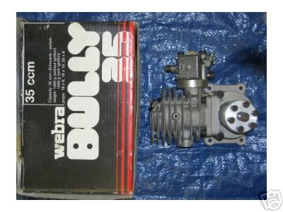

Hello,
the 35 cc "Webra Bully" and the "3w 35" = husqvarna parts (1982 - 1986? )

Same cylinder and crank, different case and ignition...There are two different cylinders, one has the spark plug at an angle, the other is straight up....
