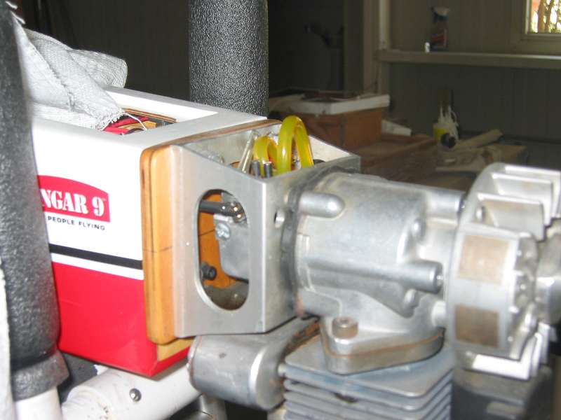

Hi guys,
I'd be very grateful if someone could tell me what the rectangular (obround?) cut-out in the side of my Wacker Engines Ryobi mount is for? Basically, I'm just about to attach the mount to my firewall and I need to know which way up it should go The Ryobi will be mounted inverted - exhaust pinting downwards - by the way.
Many thanks!
Steve

I could be wrong but Im sure if you check with Peter at Wacker he will tell you its for throttle linkage acess. Everytime I have called him he has had the time to talk with me and is a very nice person as well.

This should give you an idea. Found a used rowing machine frame that wanted to go flying!

Thanks for the replies... and yup, you're right, it's for the throttle access &/or movement. What threw me is that on the 'big bore' 473(?) carb I got from Peter it has a real long choke arm that points in the complete opposite direction to the throttle so the hole in the mount could've been for that if you turn it thro 180 Peter says to junk the choke anyway another 1/4oz lighter![sm=thumbup.gif]

you might want to check the throttle linkage clearance to the front inside wall of the mount. I needed an indentation for linkage to go to full. You could always drill a hole on the other side for the choke arm access. Seem I read somewhere that some Walbro chokes have an extra fuel channel that opens when carb is closed and a detent for a ball. Check the model diagram at : http://wem.walbro.com/walbro/family2.asp
