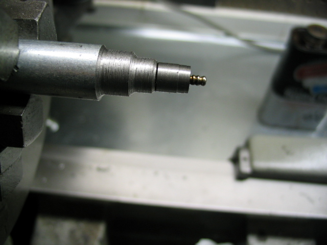

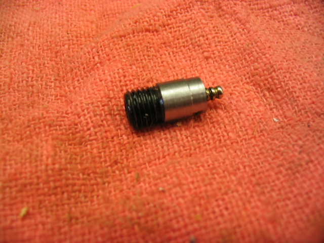

I was so excited by the possibility of using the 80gas/20methonal that I did a bit of machine work as posted in the link:
http://www.rcuniverse.com/forum/Gas_...2857292/tm.htm
So like you I was looking for a way to run my lawn and garden Airforce without a magneto, or spark ignition and not have to find a new carb.
I tried to run the mixture of 85% Methanol and 15% gas but the engine will only run if I have the choke set up to ½ open and it is not possible to meter this mixture with the stock carb.
I’m confused by your suggestion to give 80%gas and 20% Methanol a try. I don’t understand how you could keep this mixture suspended. I watched a clear fuel line while I tried to feed this mixture into the engine. The fuel separated into separate balls of gas or Methanol. It was unworkable for me. Perhaps I missed something in one of your threads.
Again, I applaud your effort and the work you have done to promote this experiment. I would be happy to try E-85, but we don’t have it here in Eugene Oregon yet. You can still breath the air here.
Please get a glass jar and make this mixture of 80 gas/20 methanol. I suspect the gas is polar and the Methanol molecule is non-polar, thus Methanol is capable of attaching to gas up to the point of saturation of point, which appears to be approximately 15%. Ethanol having a different structure must be able to bond with polar molecules at a much higher ratio.
Please advise,
Respectfully,
Poppy.

You ask me about how to make an adjustable glow plug holder / contra-piston adapter for insertion into a standard sparkplug hole in a personnel email.
I spent a about 10 minutes on the lathe and make a simple mandrel to hold a glow plug and then turned down the outside of the glow plug. The glow plug hole is a .250 x 32 threads per inch. I turned the plug down to .260 of an inch. If I went further it would have cut too deep into the plug and head of the glow plug will pop off.
Okay you can see in the photos the plug and you ask now what.
The rest of the device (Not shown since I have not made it yet) is just an old spark plug with the electrode remove and a 3/8 fine thread cut into the jacket with a tap.
Next a 3/8 fine threaded bolt in mounted into the lathe. A #3 drill is run down the center and tapped for ¼ x32 threads. Next it is counter drill from the other end with a #2 drill almost to the bottom leaving just the amount of threads to hold the glow plug (about 0.250). A wire is attached to the center electrode and the threads on the glow plug are coated with Stud Mounting LockTite.
The glow plug is inserted down into the 3/8 bolts and turned into the hole with the extended electrical wire.
This 3/8 bolt then is inserted into the old sparkplug. Now you can run the engine and adjust the timing while screwing the 3/8 bolt into or out of the cylinder. Of course you need to attach a leaver to the bolt, such a cross pin to be able to turn the bolt.

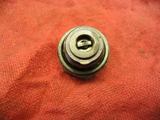

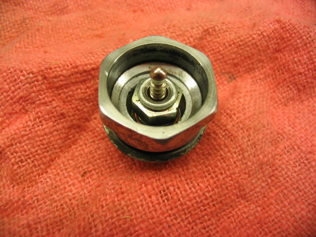

Here is a glow plug adapter with a standard idle bar Fox glow plug installed. I made it out of an old spark plug and a fine thread 3/8 bolt. In this case you can remove and install a replacement glow plug. Also note the little glow plug that I turned on the lathe. This is here to give scale to both parts.
Please don't confuse this adapter for the discription in my pervious post. I just wanted to show the basic idea and I though these shots maybe of some help to others.
With respect to the adjustable glow plug holder / contra-piston device; if a glow plug is installed with LockTite as I mention in the pervious post it will be most difficult to remove, but it is easy to just machine a new bolt/holder.
I hope these photos are helpful.
