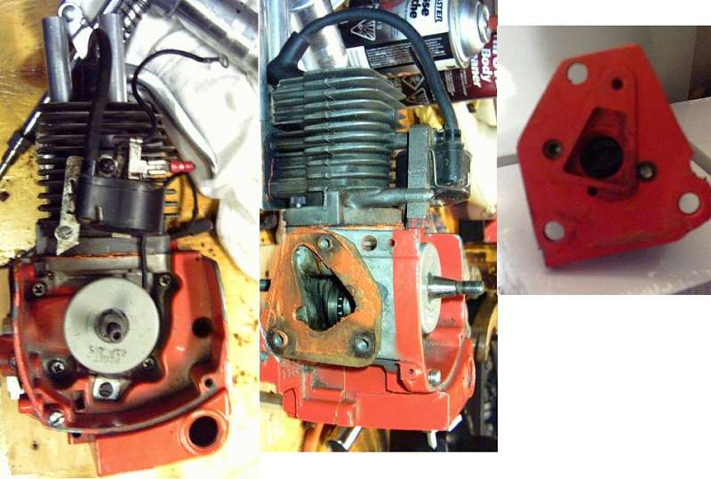

Poulan model 25, 25DA, or 25CVA are 2.1 cu.in. It has a large reed valve screwed with one screw under the piece that the carb bolts to. I would take it apart as the broken reed will still be somewhere inside the engine.

I was able to borrow my neighbors camera for 3 minutes just before he left for work. These are not the best shots but I hope they help. You can see the engine from the side, top and then the bottom of the intake where the reed would screw on. Clearly no reed there but it's not in the engine either. I am quite sure I can make one that would work there. Simple enough of a shape. Just don't know what would be the best material to use.

I spent about 1/2 and hour and I have made up something that is at least passable as a reed. I cna blow a good amount of air through the carb and it opens well enough and when I draw air back into the carb it seals right up. I don't know how long it'll last and I'd rather use fiberglass or carbon fiber but this looks like it might work.
Now after all that I find out that the woodruff key is toast. It looked fine but when I took off the flywheel I found part of it on the bench. Now I have to find one of those.
1/16" x 3/8" sound like an accurate size? That's what it looks like to me. It is the same as the one on my 33cc Homelite ZR series chainsaw if that helps.
