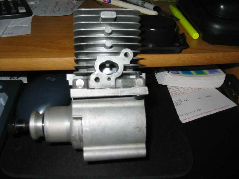

has anybody tried to run a 30cc homelite on glow. i know it will take a wt-499 carb and an adapter, but does anybody have any performance specs?

I got a 30cc Homelite in the works....here is a photo. Capt,n
