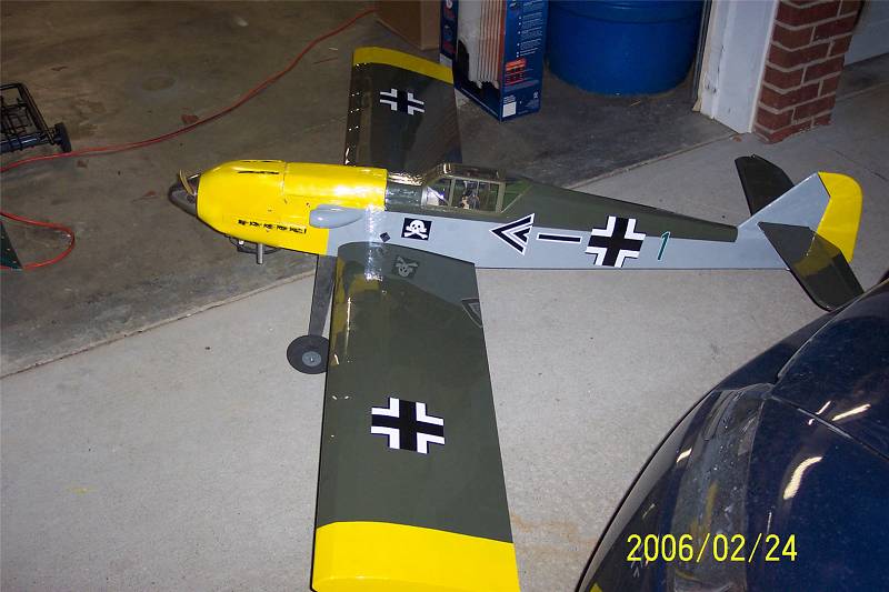

Just curious, what kind of rpms are you all getting?
With a ryobi 31, CH ignition, stock carb, I get about 6400 with a top flight powerpoint 18 X 8 prop.
thanks
bill

It's probably not broken in yet if it was new or you put in a new piston ring. You need to change the carb however. The stock carb is very tiny. A carb with an 11mm venturi would be best. Also, do you have a nice free breathing muffler on it?
I'm going to get mine out and run it some more to break it in today, but first run it turned an 18 x 6 Power Point at 7000. I'm hoping it comes up to at least 7500 on that prop, and according to the performance others report, it should do that if not more.
AV8TOR

Default RE: Ryobi 31 cc Conversion
Thanks!
It is a new motor, with dual Frank Bowman rings, and a Bennet muffler.
I have larger carbs, so I'll try one of those. it pulls the plane pretty well, but I'd like ot get it in the ballpark with other people's motors.
It lends itself pretty well to scale projects of the 120 size.
Bill

Yeah, it is definitely not known for being a powerhouse, but it fits a lot of scale cowls so nicely. That's why I did mine for in my Tiger Moth biplane. Nothing sticks out of the cowl and that looks so much better!
A larger carb should definitely help. You could also trade off a little static thrust for speed by going to a 16 x 8 prop on it for now; until it breaks in. That lessens the load a bit and makes it a little easier for the engine break in, especially in a cowled situation where it might try to run a little warm. I doubt you do much hovering or other 3D antics with this ship, so you might like the 16 x 8 in any case as you won't miss the lost thrust, and the extra speed offered by that prop will allow you to throttle back and cruise, and make a high speed pass when you want to do so. Most people use about an 18 x 8 on this engine, but it never hurts to experiment until you come up with a combo you like. Just keep it under 8000 rpms. It may turn the 16 x 8 more than that once it's got a bigger carb and is broken in.
