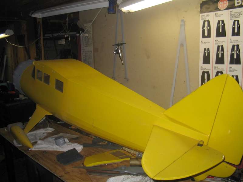

The work bench is 36x96", just to give you an idea of it's size.
A scale prop would be 24"
I'm looking for an engine that will power this plane.
I'm told a 46cc Poulan will deliver 30 pounds of thrust.
What can I expect from the 45cc Echo?

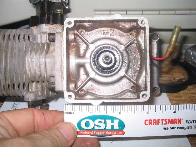

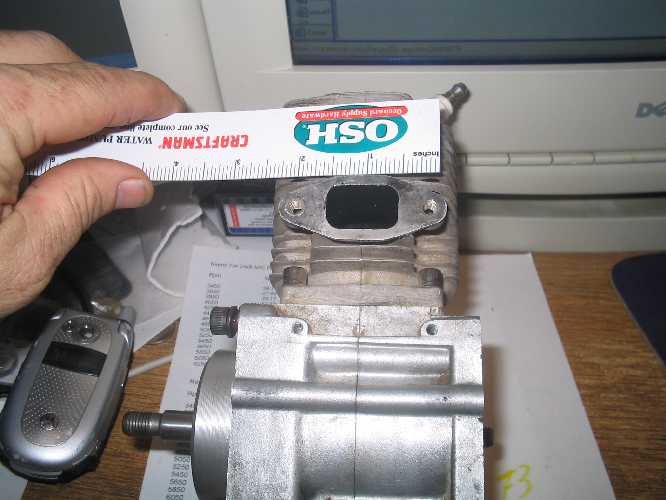

Here are some pictures.
The weight is 4lbs 6oz of that 7 oz is the flywheel.
With the nose of the Mr. Mulligan being so short weight should not be an issue.
I'll put the wings on today and check the CG.

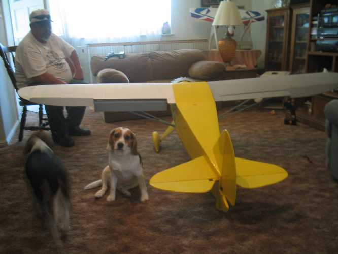

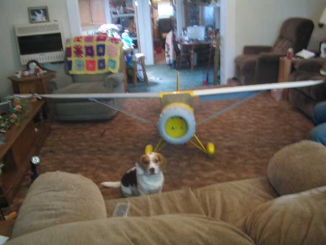

Here is the planr in my front room.
Were checking the CG and the fit of the wing.
Oh yes the wife knows.

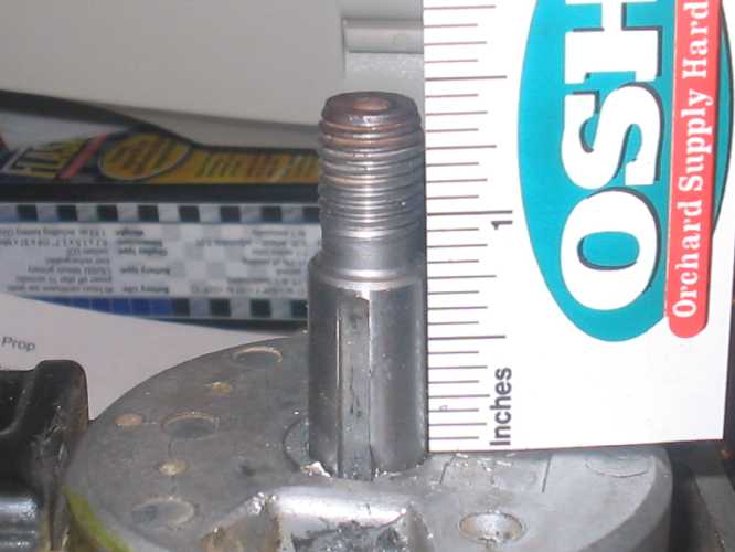

The shaft that comes out the back is 15mm that is necked down to 8mm.
It would be a much stronger mount, but I dont know about the strength if the 8mm shaft or the Left Hand threads. They look pretty whimpy to me, plus they don't look like basic mertic threads to me.
But I do have the nut with the dog gears on it to compare.

Check the threads on the flywheel end. I think that they are left handed, so the rotation tightens the nut. The other end of the shaft should be right handed. The picture of that shaft at the impeller end appears to be 8x125mm and has a shoulder. Varify that it is right handed and use it to drive the prop. Pete at Wacker Engines.com made a hub for me with 8x125mm at the shaft and 5/16x24 at the prop. I sent the nut to him to ensure the right size. It is knurled at both ends and has a large prop grip area. This would work well and the right handed thread will keep it tight. You could use red locktite to ensure that the starter doesn't break it loose. This stuff requires heat to remove.
