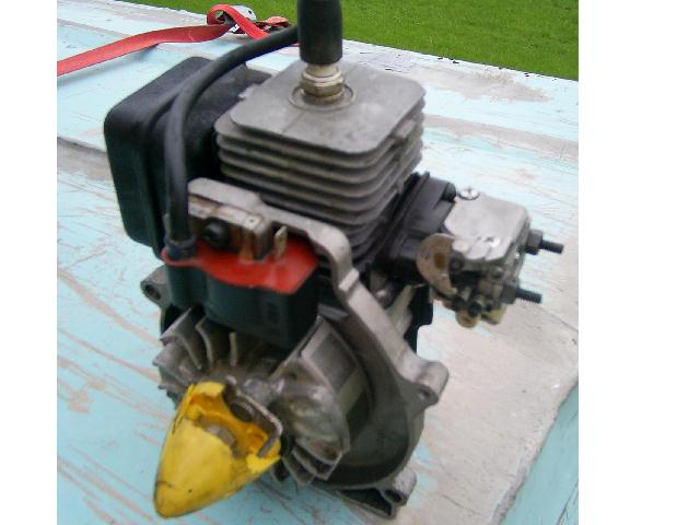

Hello,
I just bought a Homelite weed wacker the other day and took it apart,cleaned it, and put it back together in just under an hour...The only mods i made for now were to re-size the back plate and hack-saw the fins off the fly wheel.I bolted on a nose cone so i could use my starter,put it on pressed the button started in about 3 seconds...so i still need to cut away the front plate some how which is part of the crank case,any ideas on which tool to use for this job?ive got a hack saw and dremel..so i need to know which parts to order and if wacker engines has them for the 25cc homelite...i will be trying out a 16x8 wooden prop first so i need their prop hub,im gunna get the machined fly-wheel also,the exhaust,and back mounting plate...anything else?i would rather wait on the carb for now as im trying to keep spending down...i plan to put this on a lanier stinger 1.20...any feed would be great..there's some pics below...thanks for help..dustin

I had access to a big metal band saw. My 25 was a short shaft and I drilled a hole in a short 2 X 4 to stick the shaft into. With the shaft down in the hole, I sawed the lower part of the flange from the crankcase.
On the backplate, You examine the part that goes closest to the crankcase. The new rear mount bolts over this existing back plate. You want to remove everything that sticks out beyond the crankcase on the sides. You want to make the back of it flat so the new plate will rest evenly on the engine.
You may have already ruined your flywheel as far as getting Wacker to machine it for you? I broke all the fins from my flywheel and cut them off flush with a air powered Die Grinder and a A11 carbide burr. I then balanced the flywheel using a High Point prop balancer.
There's a little hole above your exhaust outlet that will need to be tapped and plugged with a 10-32 set screw.
Mine has all Carr Precision parts but Wacker parts look pretty much the same.

w8ye-i also have acess to a metal band saw i just forgot to mention that..i guess thats my best option..and to my understanding wacker sells pre-machined fly-wheels,i wasnt planing on sending them this one...thanks tho..dustin

Study all the pictures you can find on the Homelite weed whackers so you will know what to do. There are some pictures and instructions on the Wacker and Carr Precision site too.
Even after you saw the extra part of the air shroud from the crankcase, you will need to cut or file a little more off to make it look right.

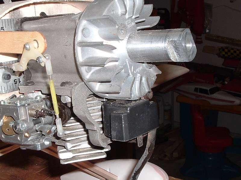

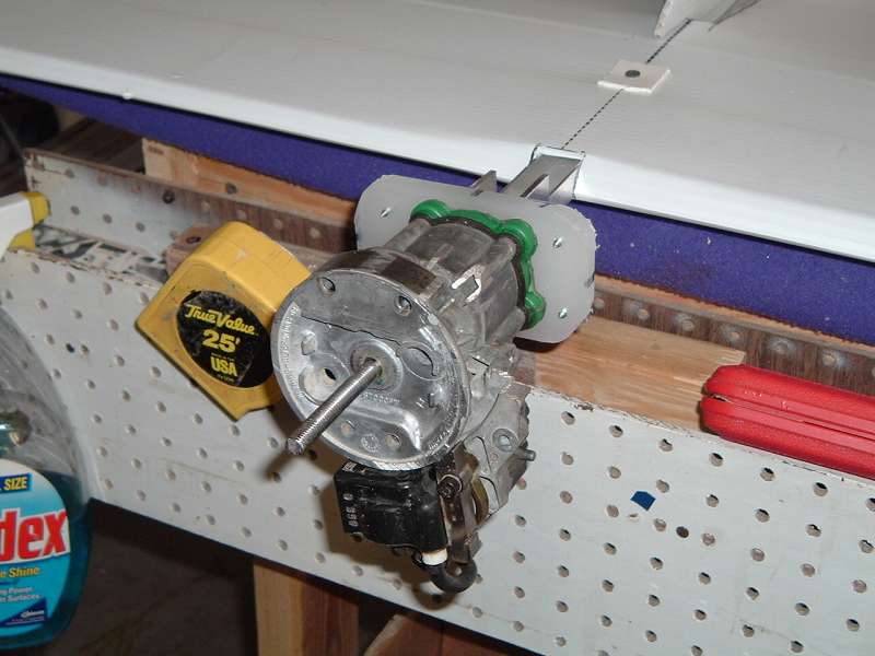

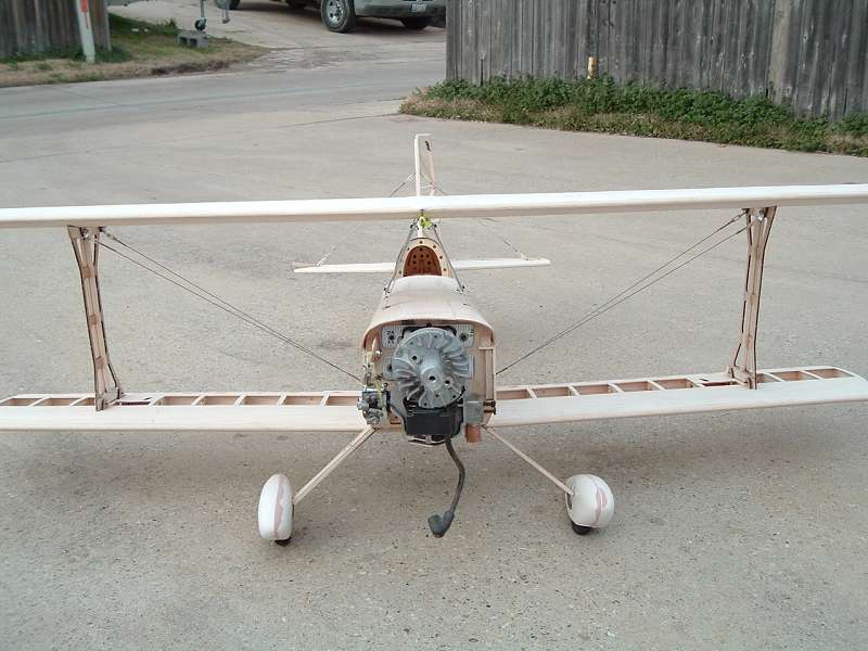

Moderator Jim.....your conversion looks too pretty!!! LOL
Other Jim.....I like your pics....the engine is nice and dirty and will probably run like stink!
Just my 2 cents!,
Tom
Mine are ugly, but really scream!
Here are some examples of my little uglies....

Tom,
Your engines look good to me. Mine is a 30 that I bought new as a short block for 60 something dollars. The flywheel is from some unknown chainsaw. It runs pretty good with the 18-8 Dynathrust shown, it runs 7500. I have another 30 that looks much neater. It has a MAS Classic 18-8 and it turns over 8,000. It has C-H syncro spark ignition. I sold my Homelite 25. It looked exactly like the 30 except it had a Homlite 25 flywheel. The flywheel was shaved on it too.
