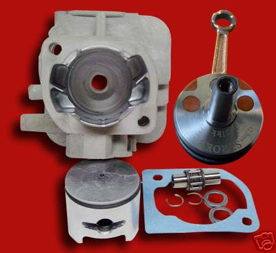

Here is a picture of a Weedeater 25cc piston that I modified for better breathing. As you can see the skirt is releived to allow the transfer ports to breath at bottom dead center.
Dave
Dave

You did lose a little on the exhust and transfers. My 25cc is 100 degree transfers. 150 degrees exhust. 132 degrees intake. You can cut a 45 degree shanfer around the piston 1/2 mm deep. This will give you back your timing without loseing the compression gain. When I cut ports I use masking tape to protect the cylinder walls where I don't want to cut. It is not a matter of if you slip, but when you slip.
Dave

If you remove the web in the transfer port you may allow the ring to catch the top edge of the port. I beleive that the ring is pinned which allows a greater unsupported area, but be careful. I would not have a unsupported span wider then the exhust port. Here is a picture of the two types of weedeater cylinders by Farley9.
Dave

I did some calculations and found that the 25cc trimmer transfers are less then 50% of the diameter of the cylinder bore. It should be OK, but I would recomend opening the exhust side transfers only. this will leave the center ring support while giving more cross section area. I am attaching a pivture of a G26 cylinder and piston. By the way your english is great.
Dave

Notice the G26 piston and transfers. It also has a full disk counter weight to stuff the case.
Dave

Hi Rysium,
RysiuM

I'm back from me holidays now, good to see some more Poulan 25's getting chopped up! Get it done and post some RPM figures[8D]
Regarding carbs, I've flown mine some more and am going to try a smaller carb, I think the WA200 is just a bit too large for low revs throttle response. Flat out screamer, yes, its the kiddie, but it just does not carburate 100% clean every time from below 2000rpm when fast throttle up.
Nice pic of the G26, it looks like a full crank engine, IE two halves, so heavy. Who needs a G26 when a $20 poulan runs 9200 on the same prop though
(8600 quoted for G26 on APC 16x8)
I think I've broken my engine though as I dropped the plane upside down onto a concrete floor and it landed straight on the flywheel breaking off the coil mount. Looks like this one will be glow only until I get another engine sorted!
