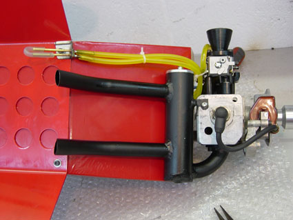

Now I got my next trimmer head (with same engine). This time the carb is different. It doesn't have a choke plate (but still has choke arm and shaft), and choke just openes the throttle butterfly. Strange - looke like something is missing or wery well hidden iside
Anyway this one is going to be 'converted' for performance. I want to get the best possible power/torque ever. Should I:
1. replace carb with 11mm one?
2. cut oprts?
3 shave the cylinder for higher compression?
I may use it for glow plug or electronic ignition. I just want the best reliable power from this little bugger

Hi Rysium,
I'm in the UK but over the last couple of weeks did a Poulan 25 converion for my Cermark Pitts biplane, and it had its first flights last weekend. I have done quite a bit of tuning of two strokes in the past so did this just for fun really, I did a pretty mild tune on it and still run the std carb and a modded std exhuast and it turns a 16x8 at 8500 running 2% synth oil in normal pump petrol and the standard magneto ignition. I wanted a nice running super reliable motor, but I'm trying to get another so I can do a balls-out tune, I reckon 9500 on the 16x8 is possible but I might break one or two engines on the way to getting there
If you want a step by step how to do this its here:
http://www.*************.co.uk/4um/i...?topic=19374.0
sorry to post a link to another forum here, but it you want the info you'll need to read that thread. Forget the first few posts as they cover a different engine, but from about post 10 to the end is my testing and development including all calcs to determine the porting etc.
Happy reading, let me know what you think.

I have a converted Poulan like yours but not flown yet,all is standard,except enlarged carb venturi to 9.5 mm
May be next weekend.
Questions:
Do you have problems with RFI, I see in the photos you have original high voltage lead to spark plug.
What spark plug?
What spark plug?
What radio control you have?
What spark plug?
1. Mount the Rx as far back as possible in the airframe
2. mount the throttle servo at least 10" back from the engine and link to the engine using a plastic link rod (I used a sullivan gold'n'rod) as a metal rod will transmit RFI
3. keep the rx aerial well away from the servo wires and battery wires and twist all servo cables to prevent RFI.
I use a futaba 138 dual conversion Rx, and a futaba T7CAP Tx, nothing fancy.
The engine has a normal Champion RCJ7Y, the one the engine came with.
I have machined out carbs before, you just make a mandrel to mount them on the back face in a lathe then get turning. Careful though, the carb still needs a venturi shape to help fuel into the airstream. Often better to just bolt on a bigger carb.
I have a WA200 carb (28 in the throat) that is 15.8mm bore at the engine end, 11mm at the narrowest point. Its unmodified as it seems fine but does need the bellmouth.
Onto your other questions:
Compression. This engine is still very conservative, it gave 200rpm but of course it also dropped the port heights 0.4mm doing this. The smallest chage probably, but you need it once you get the ports modded to get the best out of the engine. Tuning is a balancing act, there is no point just doing, say, the ports, or the compression, or the carb, as each will not make a lot of difference, but together they work to help each other give you more power.
As far as the bearings go, the engines are fine, I've run 20hp 20,000prm engines on rubber sealed bearings for hours with no problems. My main concern would be that the engine is designed to run with no end load on the crank hence has ball bearings. With a prop on you all maybe 11lbs of end load and ball bearings are not designed to take end loads.......
For machining I did the exhuast and inlet with a series of coarse and fine files and the transfer ports with a dremel 35000rpm hobby tool with a rotary burr in. Took about 2 hours in all. The liner is just the same casting as the barrel, its an AAC engine so not hard at all.
As I said, there is no particular magic change, you need to do them all for it to work. Again bear in mind I did this as a mild tune and the PTA and PAA numbers are just for a normal engine, not a full race version.
You can make the same exhuast I did the 8500 tests with, just take the outer off your standard exhuast. Putting the long exit pipe on took 300 revs off the engine but I've been making a new exhuast tonight, pics will be on the RCMF site later.
Hope that helps. Just a note, I could not get mine to run with glow power though on 98% gas, 2% oil, but it seems good on ign so I'll probably stick with that.

I just tried a new home made exhuast on my poulan 25 yesterday, and with a bit of playing about with the angle of the air into the bellmouth it now runs 8700 with an in cowl type exhuast on the std magneto and straight gas/oil mix. I hope to have anotehr engine by next week and I'll tune that one further, next stop 9000.
Rysium, to skim the bottom of the barrel I made a mandrel fr 20mm bar, put an M14x1.25 thread on with the lathe and screwed the head onto this mandrel using the plug hole. Make sure you check the squish (maybe you call it the deck clearance.?) with a bit of solder before running the engine just to be sure its okay.
Cheers,
Rich
Cheers,
Rich

Your engine was pretty extensevly modified I recognize it from another site what prop are you using and what was the gain just from the exaust? I have been playing with some exaust designs trying to figure out what will work best. I liked your engine build thread on that other site. Nice job.
Pete
Pete

I'd not say extensively modified, I only did the ports and squish to a mild tune, I've never even touched the bottom end. There is plenty left in it yet. Its just I did all the calcs first and set off with a goal in mind rather than just hacking a bit of here and there and hoping it worked.
The prop I'm using a German "Super 16x8" but I've ordered a 16x8 APC today so that will provide a very relaible benchmark for everyone.
Exhuast, have a look on RCMF and you'll see the guts of the exhuast. I found it was good on the one shown in the pic above bit it certainly needs the baffle in to provide back pressure otherwise the low speed pickup when you bang the throttle flat out is terrible. Full open pipes just knacker the bottom end performance. With my 2 exits if I block either one takes 400rpm off though!
Gain just from the exhuast, difficult to say as I said, it all works together but my new exhaust would probably make very little difference to a std engine, maybe even make it worse, same with the carb. I always get asked "what if I just did this, or just did that" well the answer is usually either stick with what you've got, or do the lot, but don't mess about doing a half of the job. If you are not sure about the calcs to get the port angles and areas, just get on amazon, buy a book and get reading. If you can do simple maths you can do the port calcs, and if you can use MS Excel it just about does it for you.
With you americans having a supply for these engines at $25 each go for it! I wish I could get them at any money, I've been searching for 2 weeks now and cannot get another at any money and the ebay seller won;t even reply to my mails.
Cheers,
Rich
