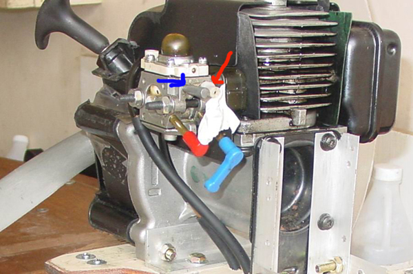

Old 06-28-2005 | 08:24 PM
Joined: Feb 2004
Posts: 523
From: NY
Default RE: engine quitting
i have checked my engine last nyt and it seems that the high speed needle cant be adjusted. the picture below shows the carb. red arrow is the low speed and blue is the high speed. anything i can do to make it adjustable?

Old 06-29-2005 | 12:53 PM
Joined: Dec 2003
Posts: 306
From: Ottawa, ON, CANADA
I see that you are using the stock muffler that came with the engine.Check to make sure that the spark arrester screens are not plugged up with carbon as this will lead to excessive back pressure in the muffler and symptoms similiar to what you are describing.I discovered this problem myself a while back when trying to tune up a weed wacker that just wouldn't run right no matter which way you turned the needle valves.After thoroughly inspecting the engine a bit further,I noticed the spark arrester screen was practically closed over with carbon.I removed the screen and fired up the engine again.The engine would now go to full power when throttled up and just plain had better performance all around.What a difference.Some park arrester screens are mounted with a screw on the outside of the muffler but some such as yours are manufactured with the screen actually inside the muffler and can't be easily removed.If you soak the muffler in a container of lacquer thinner for a few days,it will help to break down the crap that clogs the arrester screen and the engine will be able to breath much easier due to the lack of back pressure.Old tooth brushes come in handy for doing this kind of cleaning work.Gutting the muffler all together and installing larger exhaust stacks will improve your performance factor qiute a bit also.If it's not a carb related problem that you are having,take a gander at your muffler and see if you don't have the same problem that i've just described above.Good luck!
Old 06-29-2005 | 05:09 PM
platero's Avatar
Joined: Feb 2004
Posts: 245
From: Buenos Aires, ARGENTINA
The H needle is not adjustable, it comes from factory in a fixed position, you need a bigger carburetos with L & H needles
Old 06-29-2005 | 08:25 PM
Joined: Feb 2004
Posts: 523
From: NY
turbo, i have already taken the spark resistor. i guess it has more to do with the H needle setting which unfortunately is not adjustable. i guess i just have to find a carburator.
platero, are all carburators interchangable? i mean if i buy a carburator for a 50cc chain saw, will it fit this 25cc homie? cause i assume its a bigger carb than mine.
thanks foir all your help.
Old 06-29-2005 | 09:00 PM
platero's Avatar
Joined: Feb 2004
Posts: 245
50cc carburetor dont fit in 25 Homelite, the 35cc Homelite carb is the choice
