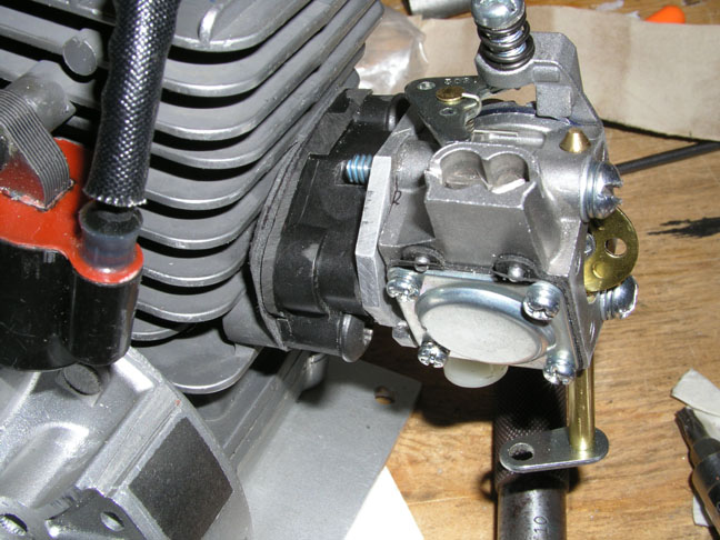

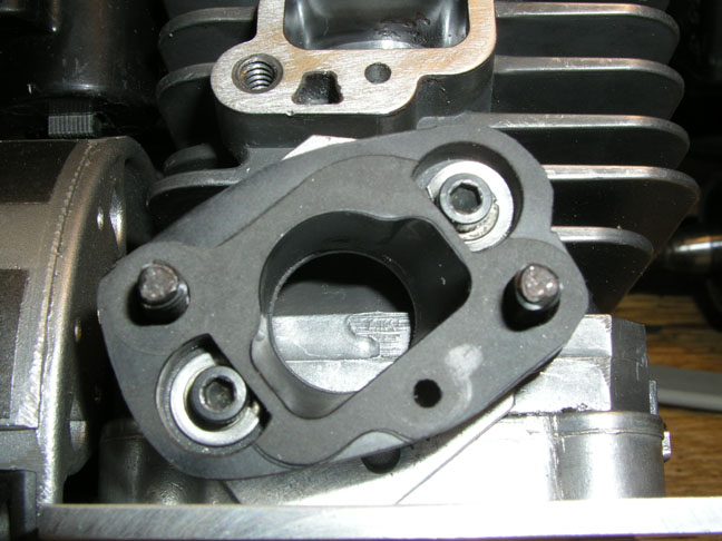

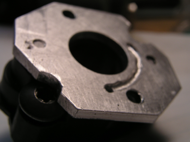

Hello everyone,
I recently wanted a straight shot rotator manifold for my Homelite 33 chain saw engine, but they aren't available. So I created a rotator plate, complete with pulse port to meet my needs. It is made of 1/8" aluminum, since that is the thickest that I could get at Home Depot. It is attached to the stock manifold with two 6-32 allen screws and washers, plus locktite. Don't forget the extra gasket with hole for pulse. I attached pictures of the rotator and carb screws modified with a dremel. If you use the idea, let know how it worked out.
Dave

Nice work. However, it is so easy to tap the pump top on the carb for a fitting, and then tap the case somewhere convenient to run a tube for the pulse to the pump that I never mess with the original pulse port when I change things around. Also, the pulse hole is often in the way when I open my manifolds up for bigger carbs.

Hi,
You are right. The reason that I made the pulse channel was to show how it is done and for the challenge. This manifold already has a 5/8" bore, so the clearances for the hole were fine. Thanks for the feedback. It is always helpful.
