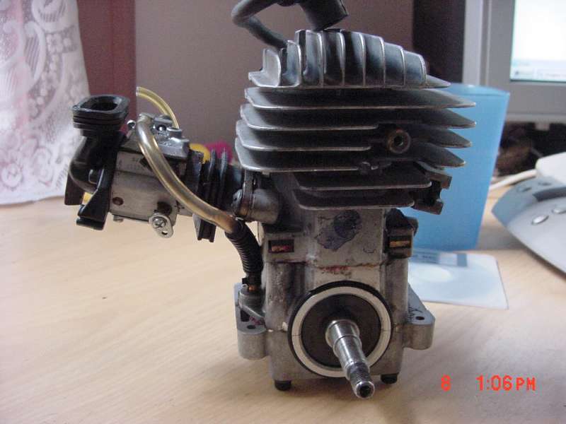

I just stopped by the saw shop and picked up a McCulloch SE3020 saw for a small price. I have never seen one of these, but it is a simple job to get going. I had it out of the saw in 20 minutes. It seems to be a nice looking little engine, nice fins, and over-all appearance. It is a 50cc engine or 3.0 c.i.
I will add a CH ignition and give it a run to see what it has to offer.
This saw was like new but had a broken clutch bell.
The weight without the flywheel but with the coil is 3 pound 11 ounces. Or that is the weight as you see pictured.

nice engine looks great, but the carb is attached to the engine with a rubber piece? if yes i think you mus to change it for a rigid one

Thats a great looking engine for conversion. Bolt on carb flange, bolt up exhust flange and built in beam mounts. The casting indicates that it has large transfers which means more power. It makes me want to go find one for myself.

Do you realize that the lower crankcase is plastic on this type of engine?

Husqvarna, Stihl, Homelite and Poulan all have models that use plactic lower crank cases.
Saws that are 7 years old or a professional grade saw should be okay.
A call to your loccal saw shop should be able to sort out the el cheapo saws

Well it was a little scary buy I knew it would be some time before the real conversion was ready to run, so I put the flywheel back on and gave it a run. The scary part was the rubber carburetor intake tube jumping all over the place. That along with the make shift throttle cable hooked to it at bad angle made it very touchy to say the least. I wasn't about to give a second run with a different prop either.
First and only run with stock mag ignition and no muffler spun a 21x8 Menz S @ 7400 rpm. It did peak a bit higher but sagged down to that rpm leading me to believe it was a slightly lean run.
I'd say it will do well once properly converted.
