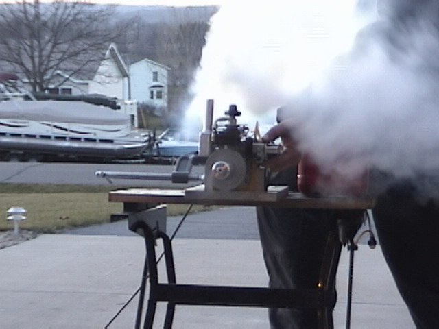

Hey Guys. I have some video I wanted to share. I test ran toro yesterday with smoke. Man did it smoke !
[link=http://www.scottellingson.com/brillelle_25cc_gt_smoke.mpg]scottellingson.com[/link]

#164
My Feedback: (29)
Joined: Jan 2005
Posts: 1,402
From: San Antonio,
TX
Hi Scott,
Man, that really smokes great. Did you just install a standard nipple or does it have a coil inside the muffler?
Dave
Dave
#165
My Feedback: (146)
Joined: Aug 2004
Posts: 1,032
From: Avon,
MN
Just a standard nipple pushing the kerosene across the exahust port. It worked very well. I did it to a Poulan 46cc also and had the nipple about 2" from the exahust port. It didn't smoke near as well.
#167
My Feedback: (146)
Joined: Aug 2004
Posts: 1,032
From: Avon,
MN
The best part is, that was with kerosene. That isn't the best to use. It has no hang time. I want to try some real smoke oil. My neighbors allready think I am nuts running these engines all the time. Wait until they see the smoke fog roll by

Hi Scott,
I agree also, that is a smoking fool for a 25cc engine. I saw a smoke test on the ground of a full scale biplane once and your test reminded me of that one. Your smoke really looks dense, the neighbors are going to love it! I must be doing something wrong because I have never started a Toro with one flip like you. Most of the time, almost all of the time, I need an electric starter. My computer stopped receiving emails, That needs fixed along with a few other projects. I am also building a new PC, so I should be able to really see the video. It is pretty cold here now to be testing engines. How cold was it that day when you one flip started that engine?

The Toro's I have done seem to flip start fairley well. I tried a different carb on that one and it was the ticket. It is a WT 15. It is 11.11mm and needed to be modified a little to work. The fuel came in on the tip cover. It had no other fuel imput. I had to drill a fuel input in the regular place and use the top cover fitting for th pulse. It Worked well. I had to buy a couple carbs from MD mower for $40 each. Ouch! I was out of carbs. The thing is the jetting must be just right for the Toro because it ran smooth as silk no matter were the throttle was. Usually they get a little rough in the mid range but this one was perfect. That engine also hand started very well. Better than any other. It was a little warm in it video. I had run it about 10 minutes earlier, but not for very long. It they are cold cold, then an electric starter is better. They still hand start but not near as easy. But if it were on a plane and you landed to refuel it would easily hand start again. Carbs are the biggest thing. I always use new ones but some work better than others.
I just ordered some avaition smoke oil to try. It should be better yet. The kerosene smoked well, but disipated fast. The smoke oil should have a better hang time. It was about 40deg the day I did the video.
