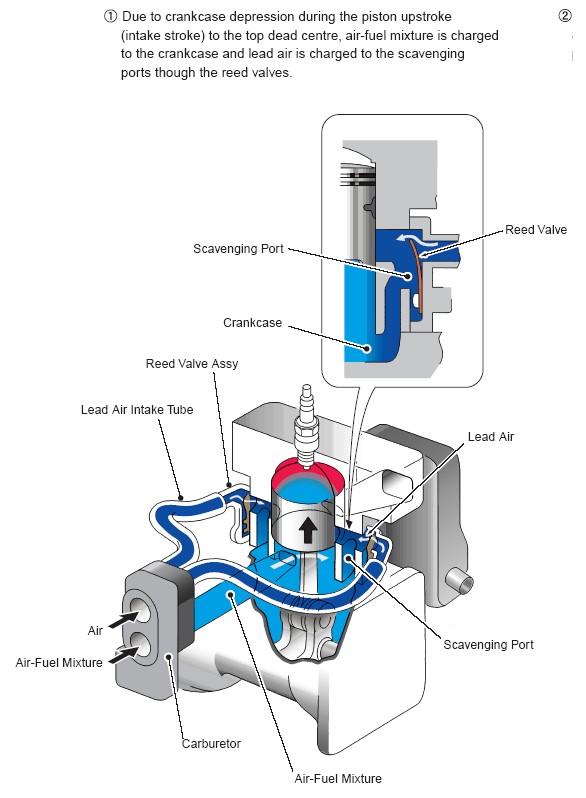

The Toro engine is interesting with the 2 barrel carb, but you've got to understand why its there. Its not for performance, its to introduce a clean air charge into the cylinder to purge the exhuast gases with fresh air, not air/fuel mix, therefore reducing unburt fuel emmissions from the exhaust. I'd be pretty certain you'd get more power from one of these by just using a conventional carb and plugging the transfer feed pipes directly into the crankcase to supply them with air/fuel mix rather than just air as per the standard setup. In effect you end up with areas in the cylinder where there is no fuel/air mix, just air, so thats got to limit its performance although reducing emisions.
Just food for thought.

Hi Rich, Since you offered an opinion on the Toro with the 2 bbl carb, I am replying to you with a few comments and a couple of photos to see if what you say and a few of us have been thinking and tinkering toward with the 2 bbl Toro, is actually possible to happen. Have you actually seen one? We know that there is an emmission component to the design of this engine with the Reed system. What we don't know is did it meet the design goals. By chance are you one of the designers?, before I put my whole foot in my mouth. The piston does not travel far enough down on the downstroke to completely uncover the two directional ports in cylinder walls. If you haven't seen one, these ports are the only ports into the cylinder and are shared by the transfers from the "main" intake port into the crankcase under the carb. If the main port and the Reed ports were two different systems this arrangement would be easier to understand but as it is, it is not. The Reeds have a very short duration of time to do anything so if any gains can be made by feeding more air/fuel through the rubber hoses to the reeds remains to be seen, but not for much longer. I just finshed an adpter plate with transitional porting to go from a cut down and slotted 2 bbl intake manifold to a WT 324 carb's 5/8" (about 15mm) at the throttle plate bore. This was a challenge to do and I haven't run it yet. I still need to make a throttle linkage for a servo, but I can run it as it is. I got tired of wondering, and speculating, and just started working on it. We shall see now. Here is some photos. The engine with the aluminum extended linkage is a 1 bbl engine with a low profile carb spacer.

Does the 2bbl carb have fuel nozzels in both barrels? If they do, the air injection idea is not workable. Reed valves open and close in response to crankcase pressure changes, so they open earlier on the up stroke and close earlier on the down stroke. This can lead to improved port timing since they respond to demands of the engine rather then fixed symetrical timing of a piston port. Maybe Toro was trying to get a little extra boost on the up stroke for more torque. I think that the piston skirt extentions which block the transfers are ment to assist the reed valve function. You sure have been busy.

I'm not the designer, or anything to do with the engine manufacturer (its used in a few different brand names) I was just interested when it came out as its a bit different, so I found out why and how it works. You probably already know this but the throttle bore to the reeds is air only, all air/fuel mix goes through the other barrel and direct to the crankcase. The reeds are only open for a very short time, the idea being a fresh air charge leads the air/fuel mix into the cylinder so the air only charge follows the exhuast gases out, so no unburt hydrocarbdons exit the exhaust. As soon as the pressure from the crankcase forces the air/fuel up the transfers it closes the reeds and allows air/fuel into the cylinder. I've got some images but its on my PC at work, I might be able to post them up next week.
Hope that makes sense, its a very well though out engine and well made, just a shame they did it for emissions not performance! What we need is a 12000rpm trimmer engine LOL.

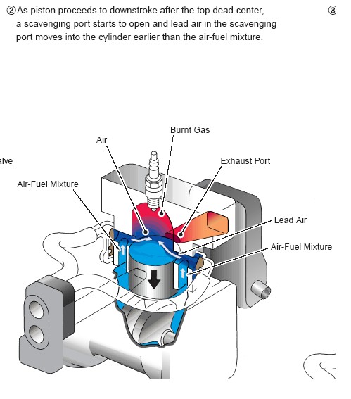

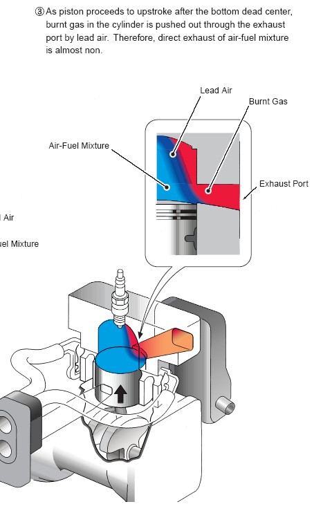

As they say a picture tells a thousand words, so 3 pictures should tell all! Here are 3 images taken from the engine tech data which explain the fresh air lead charging via the reeds as I tried (maybe not very well) to descibe above.

Hi Rich, The photos don't come up large enough, but it doesn't really matter. After I first took a 2 bbl engine apart, I could see how it worked, and as Dave Wallace pointed out Reeds work usually in one direction only and some engines use them for timing the fuel charge into the crankcase etc. I knew about these "Reed" engines, but was never really fond of them, and then I ended up with some Toros. What really got me is that the top surface of the piston bisects the directional ports and the piston does not go down any lower than 1/2 of the port diameters. I looked at that and thought, the fuel charge from the main port in the crankcase area is also flowing through these ports, which are never more than I/2 open!, and then at some point the Reeds must only open for an extremely short period of time, so That is why I increased the diameter of the ports. I then wondered if I went too far, but after all the tinkering it still runs and I gained about 500 RPMs. The velocity of the fuel charge through these 2 bbl engine ports must be pretty high. I made them about 20 to 25 percent larger I would guess, I wonder how far you could go, but I am not curious enough to try it at this point.

its to auto resize thing the forum does that messes up the pic size. Just click to open it full size, right click and save the pic to your local drive, then open it at actual size (100% zoom) in any photo software.
Sometimes with transfer ports the manuafcturer has the port only half open (actually the port is twice the height) as it stops the ring riding over the lower edge of the port so extends ring life. I don't know if thats the case with the toro.
