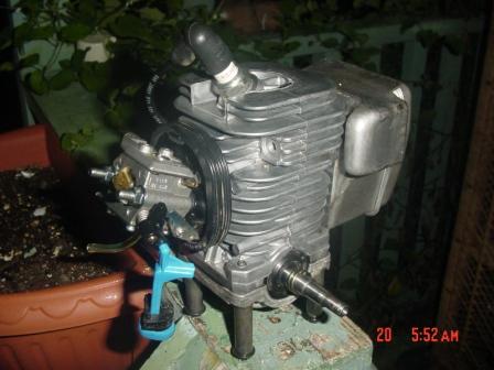

Personaly I am converting a Poulan 42cc.. But I came across this site and thought that those looking for an engine to convert could benefit from it..
But I see what your saying... the crankcases do look to be made of some cheap alloy instead of aluminum like most chainsaw engines....
Anyway I attached a pic of the engine I'm converting ...
>>42cc Poulan Pro
>>CH Ignition on order
>>Pits muffler on order
>>12.5mm WalBro carb
>>Velocity stack on order
>>I am also going to have a few of the cooling fins machined down (just a little) to try to save a couple ounces.

Don't spend money on fin machining until you put it into a plane. You may find that you need the weight anyway to balance. If you trim fins, do the ones closest to the crankcase. Look at a BME 50.
