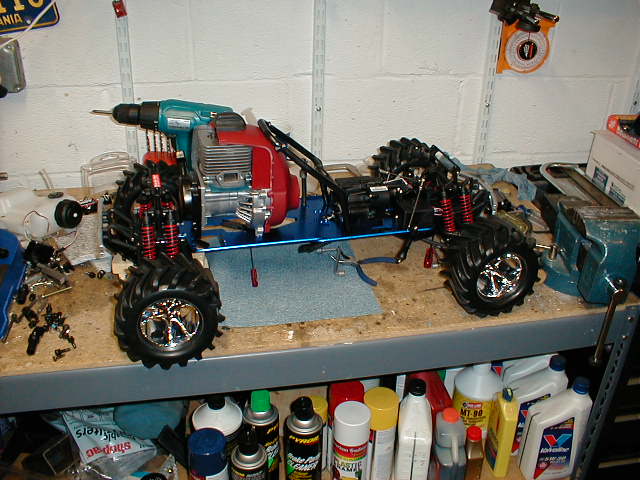

well this is what i have right now. a 25cc weedeater engine with a walbro WA207A carburetor.
i took it apart to clean it and i broke one of the "tabs" that goes over the inlet valve.
i have a feeling that it is a reed and need a new better carb or a rebuild kit.
i am looking for advice on engine/carb selection
ps. i am planning on doing something like this...
(ITS not mine it is DR. Honda's)

Unfortunatly, you either have to provide a better description or good pictures of it. Weedeater did make a rear intake reed valve engine a few years ago. Model XT-90 etc. The muffler is held on with springs and has a round cylinder port. Is this the engine that you have?
Dave

yes actuallty it is but i got something better now......

That Echo has a clutch and good cooling. It should be great for an MT. Well made engine.
