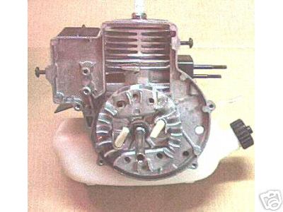

i need to know if there is any way of pulling more power out of the 32cc talon motor. its also the 32cc used in the mac. i need to get as much out of it with out removing the mounting plate between the flywheel and the motor because i've used this to hold it where i need it. heres a pic of a converted 1

Old 01-02-2006 | 09:14 PM
tkg
Posts: 3,114
From: Riverton, WY
Default RE: talon motors
Try sloting the screw holes in the mag mounting place. This way you can try changing the timing for more power. Change out the muffler the stocker is quiet but, its a real power robber.

Old 01-03-2006 | 01:46 AM
Joined: Aug 2005
Posts: 68
From: adelaide, AUSTRALIA
i got a picture here. that plate behind the flywheel, where the mounting holes for the screws are is where it holds on to my homemade cowling.
and the second pic is sort of what the motor is used for ... mines better then that
