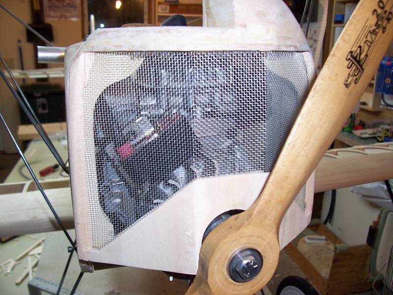

I have a Briggs and Stratton 34cc, runs great and flies a GIANT stick (96" wing, 25 pounds) just fine. Slow but fine. I am now fitting said engine to a BalsaUSA Fokker DVII (fits perfectly) and am hoping to maiden it in a few weeks. Several friends have converted other brands, Honda, Ryobi, etc. Everyone has had great luck with them. If you are looking for power, go elsewere, its the sound that is so great about these. A buddy put a Honda GX31 on his Balsa USA Fokker DR1 mounted inverted and it flies and sounds like the real thing, and yes, I have seen the real thing at the Dayton Ohio Dawn Patrol (Man oh man was that a great show)

How does your engine mount work out? Mine was a real shaker but I think it had to do with the rigidity of the mount. I'm in the process of turning the fins off the flywheel but the belt on my lathe broke. I'm planning to check the balance of the flywheel when I'm done. If you do a search for my login name mgnostic you should be able to find a pic of my four stroke project

Mine is hardly shaky at all, no more than a standard two stroke that is. I do have a ryobi that is very shaky though.

It turns an 18/6@6500 RPM, it actually used to do 7000 RPM, I am not sure why I have lost power, could have something to do with messing with my carb and not getting it back to "Just right" but at 6500 it flew the 25lb 96" stick very well. The Stick would do inverted flight, loops, rolls, wing overs, etc, not alot of vertical, but enough to do the manouvers like I said.

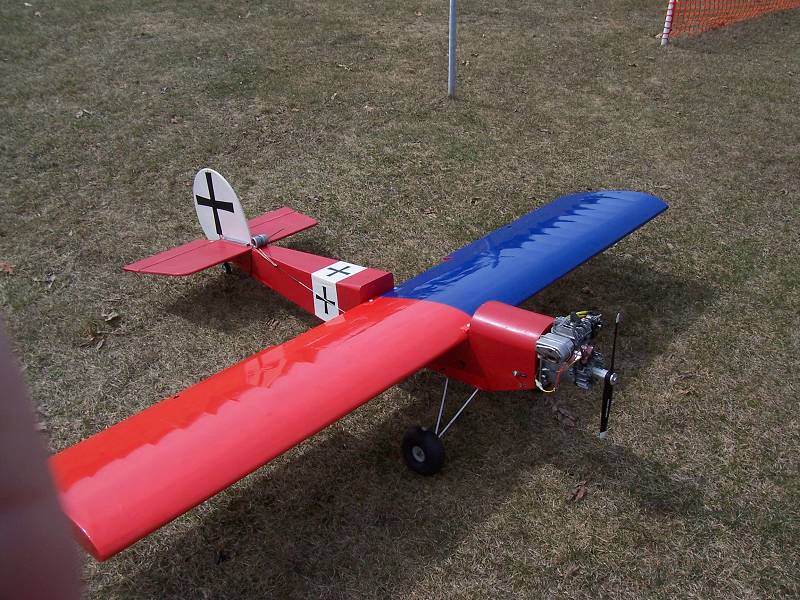

That sounds exactly like my Aeronca, you will have no problems at all with a 25cc, I certainly dont. Here is a picture of my DVII with the four stroke gas engine mounted and the muffler we made for it.
