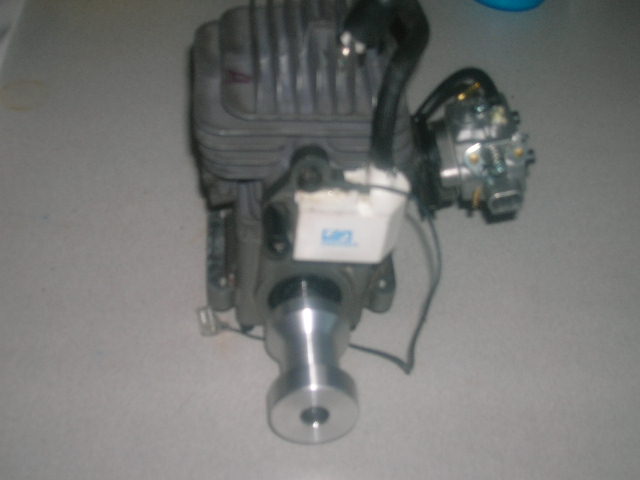

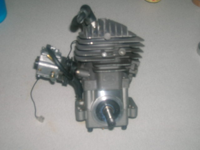

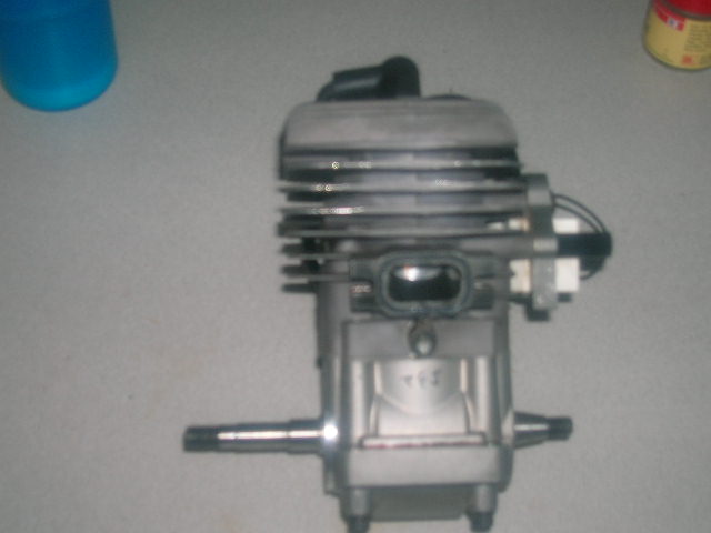

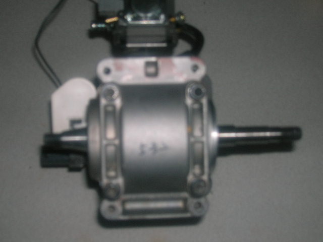

Well, I bought one at sears today. It was slightly used so I got it for 160.00. It took about an hour to get it out of the saw case and cleaned up.So far I am very happy with the way it is coming out. First, the coil is mounted on the cyl. so you dont have to run electronic ignition if you dont want to.Secondly, the cases look to be machined really nicely(much more so than the homie45s or the poulan 46s) The carb is mounted to a rubber boot BUT, the carb will NOT come out like the 46 poulan or newer homie45 OH and also it has beam mounts ready to go..even the holes are there! IM not sure who makes the motor through, it has a "JL" symbol on the cyl and on the coil.IM really suprised other people arent converting this motor...should be a good one....i hope oh, the flywheel is also lighter than any of my ryobi or homelite flywheels and machined nicley as well.I try to post pictures tommorrow.

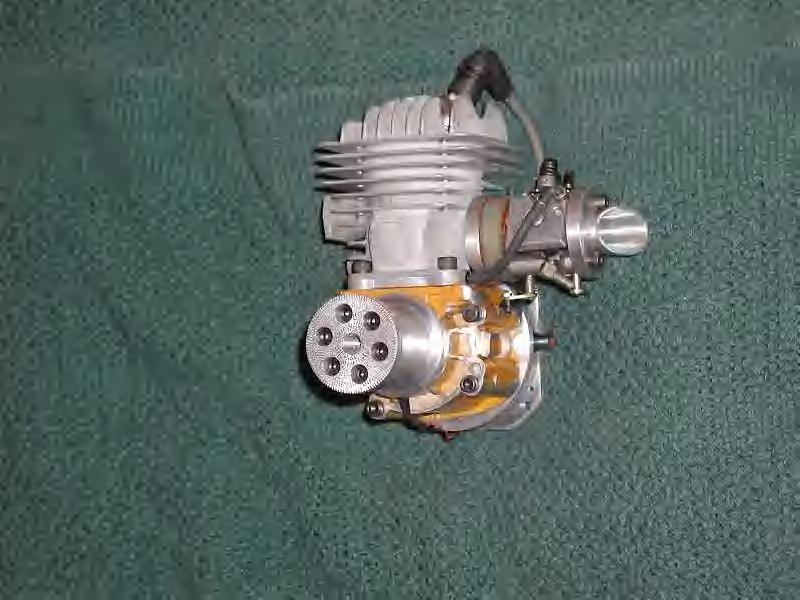

Old 10-09-2005 | 09:42 PM
My Feedback: (29)
Posts: 192
From: algonquin, IL
Default RE: craftsman 55cc anyone done one??
[img][/img]here are some pics of the motor. the prop shaft isnt for this motor and is just to see how she'll look with electronic ignition

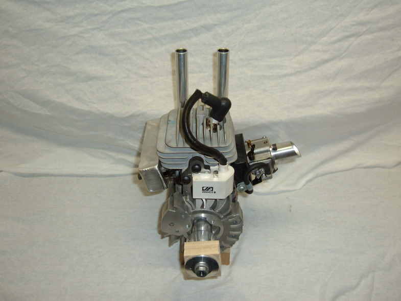

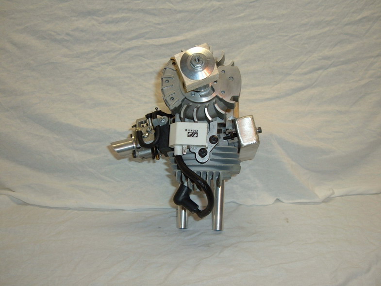

I just did one, made a custom intake and exhaust. Came out OK with decent numbers. My first runs on the stand were with a B&B short tube muffler now I have to run it with my custom muffler!

Old 10-23-2005 | 07:16 PM
Joined: Apr 2003
Posts: 102
From: Quakertown, PA
Well I finally got to run the engine with the new muffler. With a MA nylon 20x8 it turns 8100 and with a MA nylon 20x10 it turns 7200. Respectable numbers for the weight. Without the muffler it tips my scale at 4 lbs 6.5 ozs, with the new muffler in the picture it tips my scale at 5 lbs 6.5 ozs. The weight savings of running electronics would really help this engine, I didnt weigh the flywheel and coil by its self but Im guessing at least a pound. I did the engine just to see what it would turn out like and since I have too many converted engines as so as it is, Im thinking Ebay will see this one in a week or so.

Old 10-23-2005 | 07:25 PM
Joined: Feb 2004
Posts: 293
From: Timmonsville, SC
It looks very good,i'm going to try and find a chainsaw like that and do a conversion of it. Did you make the parts for this motor? What will you be selling it for?
smallplanes
Old 10-23-2005 | 08:00 PM
Joined: Apr 2003
Posts: 102
The intake I custom made, the exhust was made between me and a shop. I cut all the aluminum they tig welded it for me. Prop hub is one I had laying around and I cut the flywheel down on my drill press but a shop cut lighten it a bit more. I have a price Id like to get, really depends on what people feel its worth to them but I wont sell it for less the 200.00 the way its pictured.
