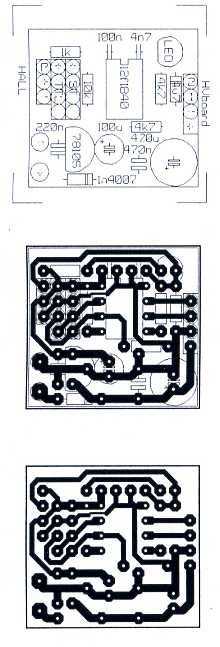

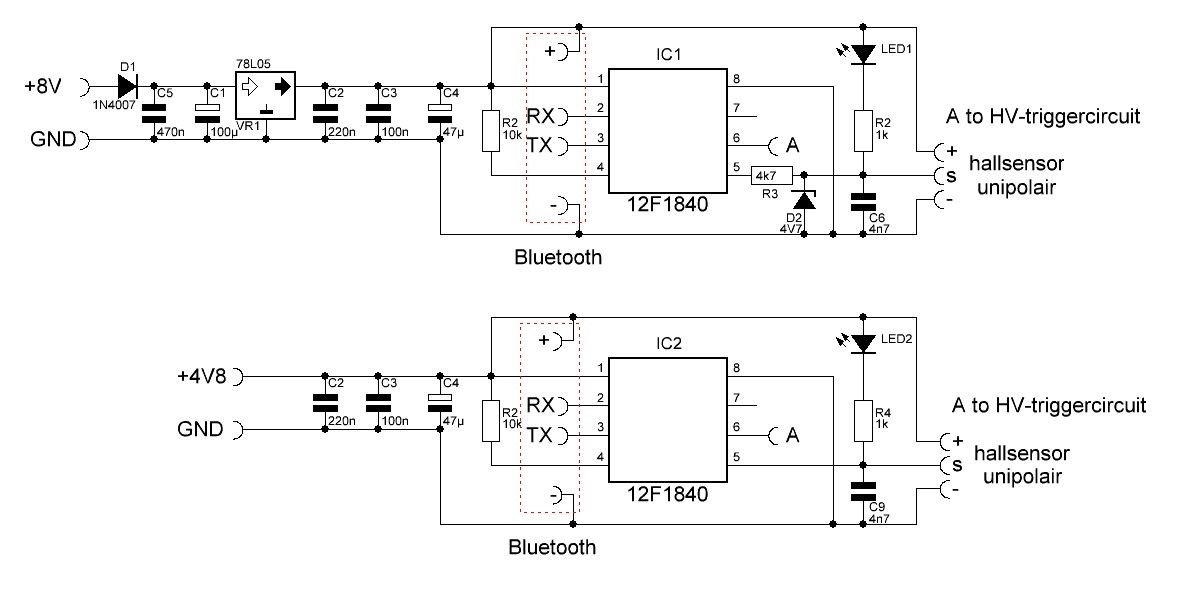

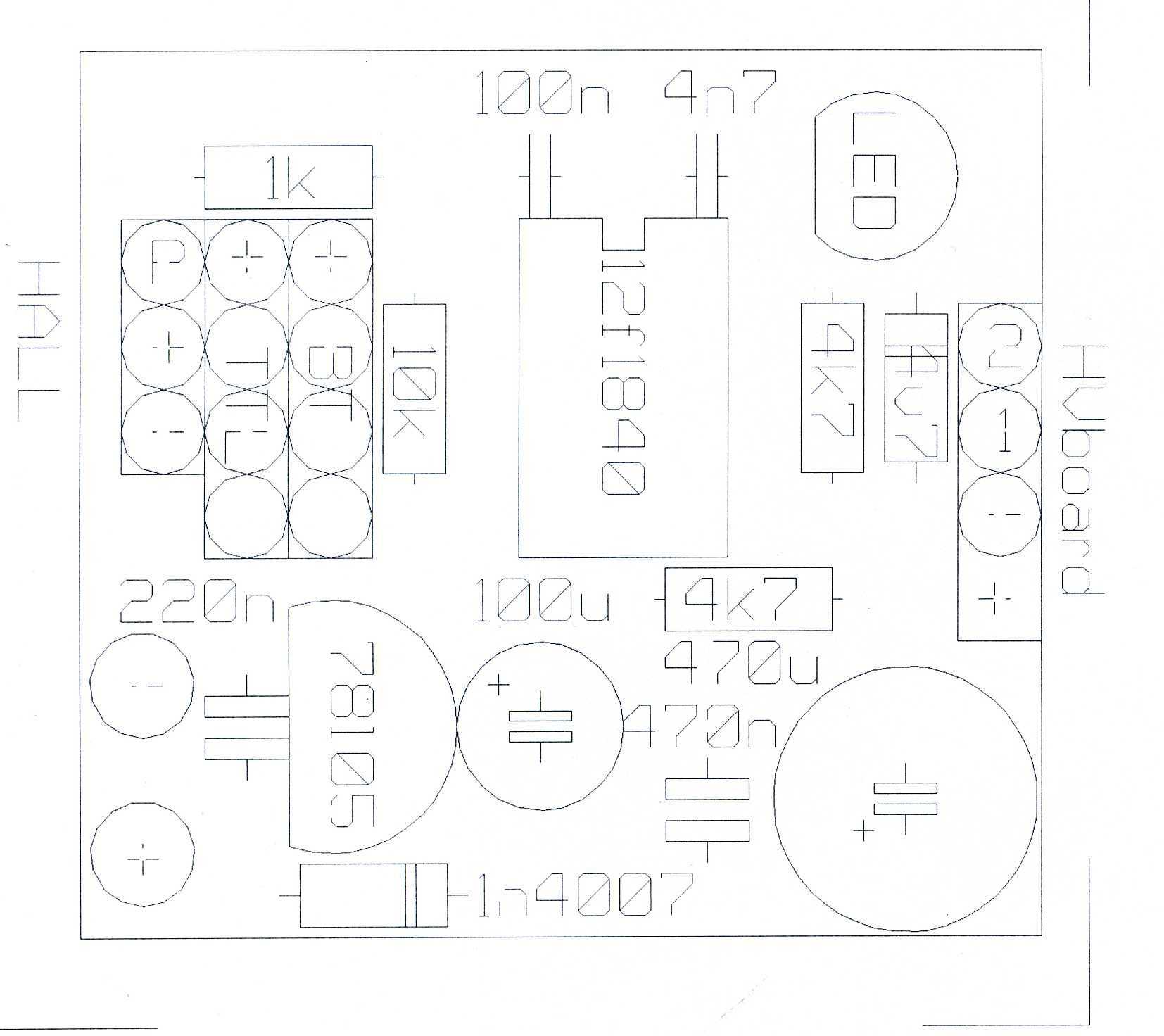

I am trying to locate the original circuit diagram of Jons opensource cdi .
Any links do not work and the gompy.net links are blocked by my malwarebytes antivirus.
I did build a version of this CDI at least ten years ago but lost the schematic and am trying to re-create it.
Any help would be most appreciated.

Many thanks for that, the PCB layout is a bonus. However I need the HV schematic and coil data.
Can you help on this too?
You help is much appreciated.

Here is PDF copys of the pages from my old site..
I lost inerest a long time ago...
