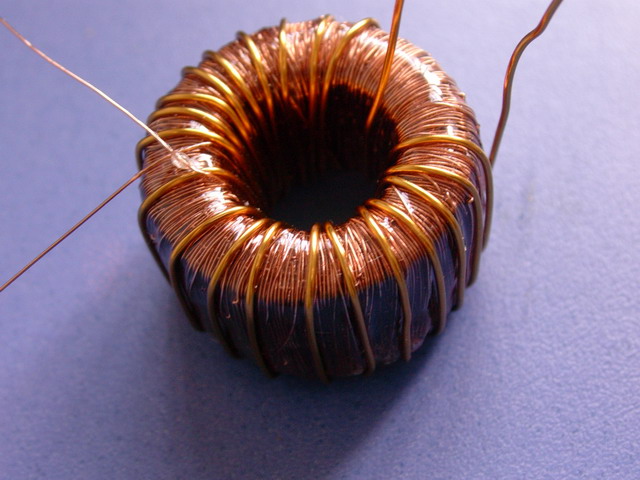

couple of questions JMJ, I made the circuit last night but it does not work quite right. On the far right of your schematic there is a resistor and capcitor (C6 and R1) now it says on the diagram to use 4.7uF, but in the parts list it says 4.7nF. I'm just wondering if this is my problem. It makes enormous sparks, but the circuit free runs at about 1Hz, it sits there happily sparking to itself but I'm getting over 600v from the diode bridge[:-]
PS, your toroid pics, is that really 0.1 wire for the 450 turns, it looks a bit thicker? I gave up on 0.1 as my fingers are too big to wind it so used 0.2.
Cheers,
Rich
Cheers,
Rich

C6 is a electrolytic capasitor of 4.7uF/16V. Obviously an error in the parts list, sorry.
If you get 600V, at least the high voltage board is OK. This is a new record, the most i have got is 350V.
If it sparks by itself, it sounds like you have activated the test function, or have a problem with the PIC.
Try removing the wire bridge between the 2 parts of the board, and see if it stops.
The wire in the pictures is thicker than 0.1mm, it is not a picture of my torroid.
I used 0.1mm, but it is not important.
Jon-Magne
