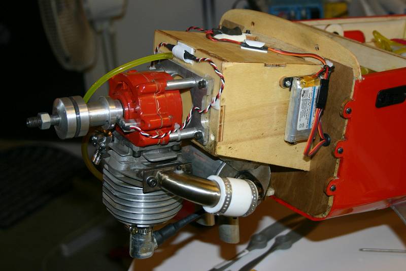

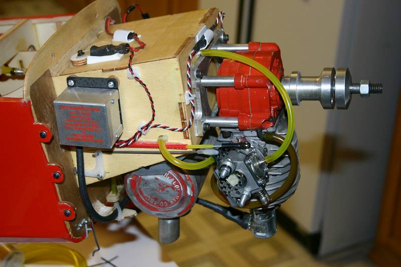

I flew my converted 032 for the first time yesterday. It is on a 27% CA extra. All up 16lbs. It ran great with good power and throttle response. This was a new engine and a new air frame so I only put a couple of flights on it then went home to recheck everything. I made the prop hub, muffler etc myself and put a C.H. ignition on it. All together I have less than $300 dollars in the complete power package. This includes rebuilding the donor engine with new bearings and rings. The guys at my field were mildly interested before it flew, but after seeing it, came over to give it a closer look. Turns a 20x12 up the same as a DA that I checked. I will try to upload a couple of pictures of the engine later.

how many ccs is this engines and what was the all up finished weight of engine.

Its a 50cc and weighs 2lbs 14oz with out ignition and muffler. My home made muffler weighs 5 oz. I did not weigh the ignition system.

one thing nice about the 032 is that the exhaust port is the same as the DA 50. bolt holes and everything, Any muffler for a DA 50 will fit this engine,

I uploaded pictures to my gallery. Can't seem to figure out how to post them directly.

Pictures
ID:	343877   Click image for larger version

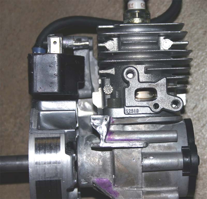

Looks good. Did you mill the fins down or were they allready like that? How much for a saw like that new?

I turned the outside down in my lathe. then with a parting tool thinned the fins. Just the thinning was worth 2.5 ounces. Not sure what they cost new. my local Stihl dealer had a pile of motors in there scap bin. I also bought a running used saw for $75 that I am doing some more extensive mods to.

Thanks for info Mark. You did a good job on the fins and the motor. Every ounce off helps to keep the plane light.
