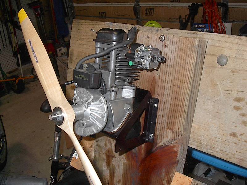

Here are two pics of mine on the stand. I do not have a muffler on it as I have been playing with different types to get the sound I want.

Hi Brian,
Thanks for the pictures. I havn't run it yet with this exhust stack. It is about the same size as the port and very short. Is that the stock carb? Mine uses a drum type 9mm carb. I have an 11mm drun carb from a Toro that I want to try. I think that I need to add a spring because of the single pulse of the four cycle.
Dave

No that is not the stock carb. I didn't like the strong tension on the barrel type type carb so I changed it out. I shortend the plunger spring some to allow for the 1/2 pulse from the intake to move the pump diaprham. It's a little rich at idle, but transitions well. I have not tached it with this carb. The old carb gave 6300rpm on a MA 18X6 woody. I may tach it today if I get the chance.

Hey...just for kicks....see if you get more RPM after cutting down the back-board close to the back of engine. If not more RPM...mabe more pull. Just wondering!!!
