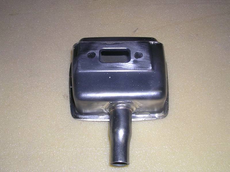

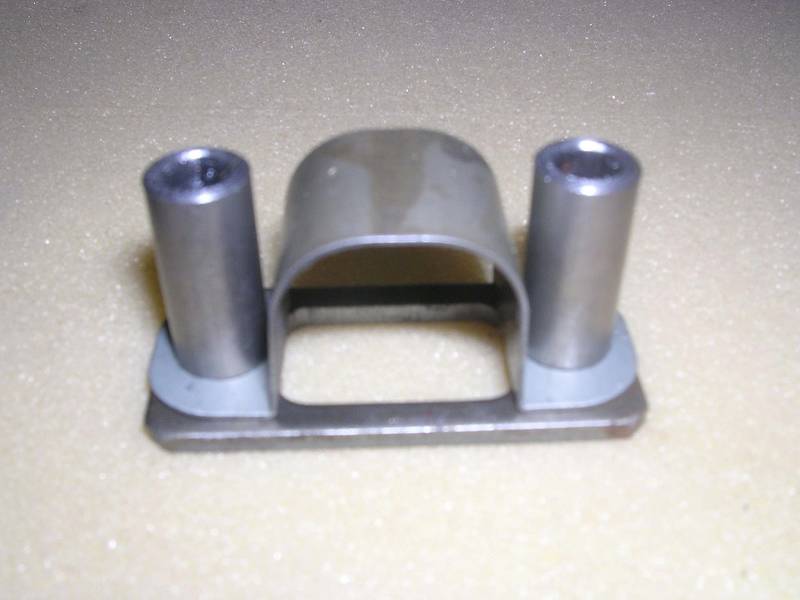

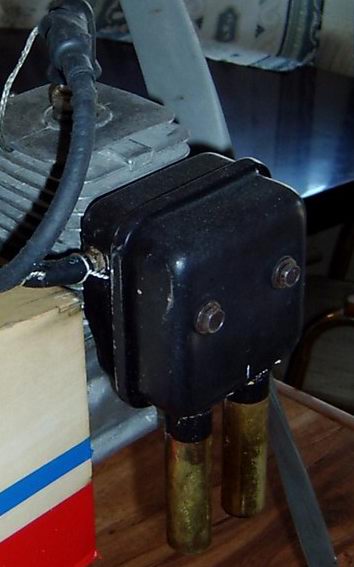

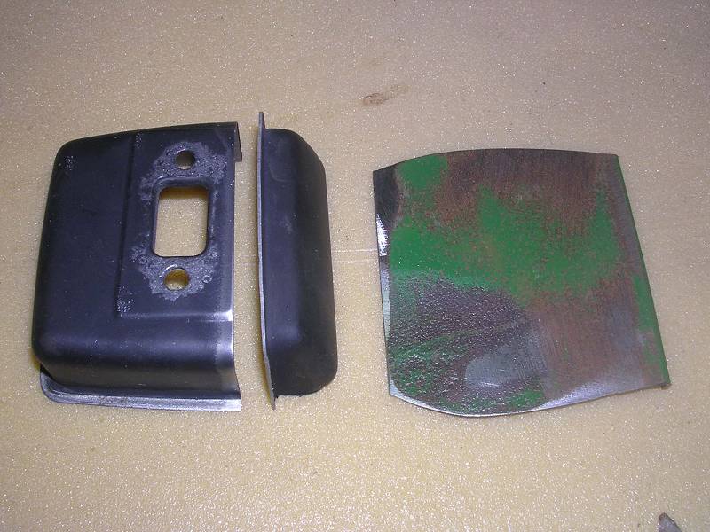

(1) grind the crimp around the outside edge until it falls into 2 pieces (2)baffle and standoffs will fall out then remove screeen and insulation, grind off the spotwelds.(3)cut 2 halfs as in pic1 (4)cut off .525 from standoff length pic2. (5)get a piece for the side and cut to shape. i used a case from a junk cd drive. pic3 (6) cut out the pipe and grind it round so u have a flange around the pipe for soldiering pic4 (7)silver soldier the 4pcs together, dont forget to put in the baffle and standoffs inside first! i used a white paste flux and small dia silver soldier. i cant believe it myself but i used a burnzimatic torch for the heat.(8) bolt it to your new toro conversion pic6. im not to sure bout the pipe dia. but it worked for toro so ill try it. it weights in at just ove 3oz

I ground my first muffler apart like you did. Later, I discovered that you can usually carefully pry the crimp apart with a screwdriver to disassemble the muffler. When I put it back together, I just smear a little JB Weld on the joint, press it back together and re-crimp with pliers or some careful hammer taps. Works great and no leaks.
On mine, I braze two 7/16 or 1/2" i.d. outlet tubes. Seems to work great. In one review I read about the G-26 Zenoah, it made more power with larger outlets. If you get too carried away though, they get pretty loud and the idle and transition isn't good.
Questions: Which type of silver solder did you use? Sta Brite, or the real high silver content type? Also, have you run this and will the silver solder hold up to the temps involved? I braze mine, but if it works, the silver solder would be better for the thinwall brass outlet tubes I use.

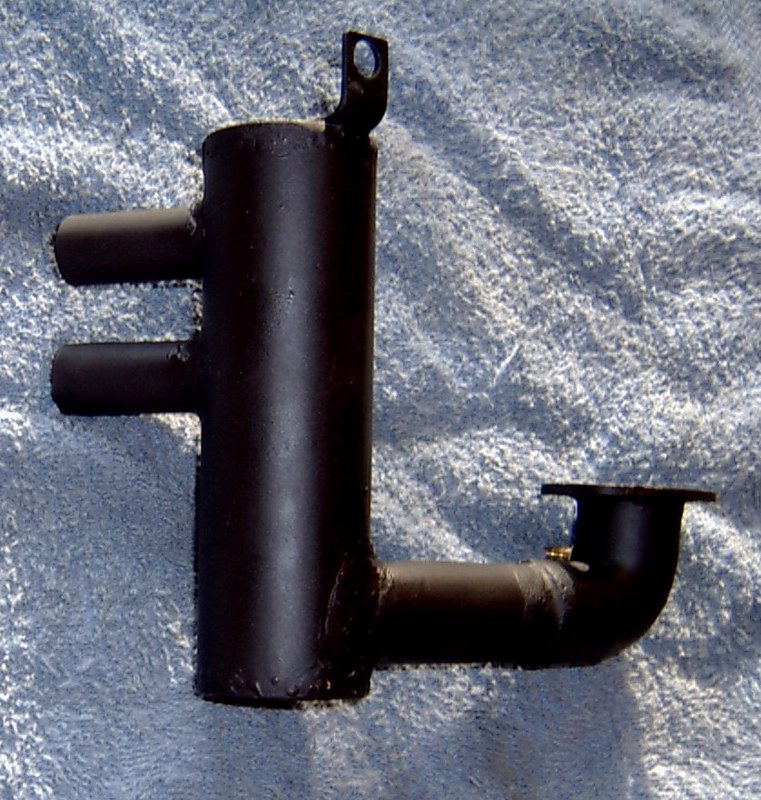

Here's a pic of a Homelite muffler with smoke attachment, and a muffler I made out of plumbing parts for my Katana.
AV8TOR

I use real silver soldier with a melting point just at dull red on the steel so im sure this isnt gonna come apart, if the muffler gets red ill need more than a new muffler. a aluminum muffler would melt at the same temp as this soldier does. silver works so much better than braze because it flows like lead does when u use the rite flux at the rite temp. i havent run it yet so im not to sure about the outlet pipe. we have a noise limit at the field so i maybe stuck with this size pipe outlet pipe. i will try different size just to see tho. i can cut off the reduced end and have a larger dia outlet. the nice thing about this fabrication is the size and weight. so far i dont know about the noise and power effects. its only 1/3 the size it was when i started
