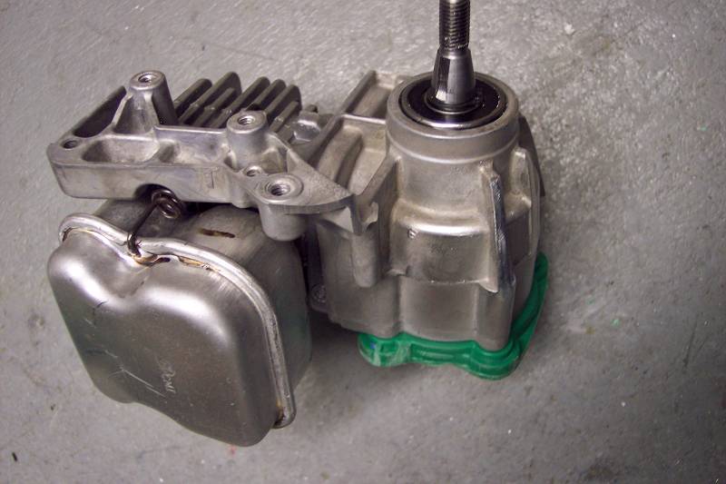

Hi David, Here is a few photos so you all can see what the 4 bolt 25cc Poulan Featherlite looks like, before they went to the 2 bolt backplate, a bolt on muffler (I think) and a different design carb spacer. I started the conversion on this one for the photos. This engine is about as easy to remove the flange on as a Toro. For reference the flange part removed that you see in one piece weighs 2 and 1/8 ounces. I leave part of the flange supports on as braces for the crankcase snout, which is easy to do. If you grind them off you will only remove a minute bit of weight. You do need to open the ports on these. I open the intake a lot and try not to compromise the carb pulse hole. The exhaust port needs a bit of squaring up and the muffler needs to be opened up. The single needle original carb needs to be replaced with a 2 needle also. I tried the single needle carb for reference and didn't get very high revs from it. For reference, the original carb from a 25cc has a 1/2" bore and a 8mm venturi. the Zama I use is a M29D - 86A with a 9/16" bore and a 9.5 to 10mm venturi. (Hard to measure without removing the choke.) In general I think these are nice fairly light weight and compact engines. They can still be found for reasonable prices. I got 8000 RPMs from my first 25 like this one with a 16x8 MA Classic and want to see if I can duplicate the performance with this one. I ran this before starting to convert it and it sounded very encouraging. Someone broke the Trimmer shaft on this one before the engine had much time on it. This is a common occurance with these. My first one had the plastic shaft mount broken off before it was ever run. I got them both off of ----.

Roll,
That looks exactly like what I have, except the cylinder. I have the 4 bolt, spring muffler, and 2 bolts for the cyl to crankcase, but the cooling fins are deeper on mine, and one side has notches for the bolt, while the other has holes large enough to allow the bolt to be withdrawn through the head. Yours appears to have a larger bore, but about the same outside dimensions to the fins. I bet mine is the 18cc.

I submitted a post last night to this, but somehow must have not posted. I got a new 25cc trimmer and a used homelite 33cc saw yesterday. Took the trimmer apart, and its a two bolt crankcase, bolt on muffler. Theres an o-ring seal on both the backplate and the cyl to crank, and the cyl bolt spacing does not quite line up with the older 4 bolt cases. The holes could easily be filed to make the cyl fit, but I think the porting would be really off and likely to affect the power, thats a guess cause I didnt look that close before abandoning the idea of using the old case. I wanted to use it because I have stuffed it and had the mount already made, but like you said its not that much work to repeat. The new cyl has a flat base, no ears on it extend into the case, and the o-ring groove is in the case, so it will be really easy to take material off the bottom of the cyl to raise compression. Gonna start cutting on it tonite, I'm still relatively in the dark about the timing and durations, and cutting ports, but I think I can at least get a little more power than stock out if it....what mods did you do specificly to get 8k out of yours on the 16x8? I want to use a Bolly 18x6, I need more thrust than speed with this plane. I really like that Bolly, I have a 14lb or so H9 Tcraft with a G23 on it that flew good on MA wood 18x6, now with the Bolly it leaps off the ground and will hang on the prop.

Hi Dave,
I am guessing that you bought one of the two bolt crankcase Poulan engines. I am not familiar with what the intake port looks like on those. I would be a bit conservative on porting at first because, as you no doubt know, you can always enlarge them further after a running test. On my engines as I said before I bored out the carb spacer to 1/2". Then I used a metal scribe to draw a line inside on the aluminum with the spacer installed. After removing the spacer, I could see a point from which to start. I followed the 1/2" outline and filed the intake downward in a internal curved shape. I stayed away from the carb pulse port on the right side. Now the port is 1/2" high and a bit more wide because I sort of brought the left side down and the bottom over to the left to create a squared off lower left corner. I made sure not to kick up any burrs at the cylinder inside surface. From the left corner across the port to the top right of the circle is a bit more that 5/8". This is a large as I could possibly go on the port. I wouldn't suggest being this radical at first with any engine. Then I worked over the exhaust port as much as I thought I could get away with, but it wasn't as radical as what I did with the intake. then you need to open up the muffler to let the engine breathe. As far as a 25cc engine turning a Bolly 18-6, I don't know. To begin with I am not familiar with the prop. A light airplane as you describe could very well be compatible. Next time I run one, I will try an 18-6 and see how it goes. I also need to see for myself if I can duplicate the 8k reading with the two 25cc engines I have now. Oh Yes, You mentioned machining the bottom of the cylinders. I removed about .020 from the 21cc cylinders because they didn't feel as though there was much compression and I wanted to see if they would be easier to start. This seems to have helped the 21s operation all around and they went from 6k to 7k with the same 16-8 MA Classic prop. I didn't do this to the 25cc engines, could be a possibility?? I would suggest trying this on your first engine first. There isn't a whole lot of material thickness to the cylinder mounting flange to begin with so check that and the spark plug clearence before you start cutting. I have also thought about sinking the spark plug a bit, the botttom thread and a half never get used as it is and this might be an idea. Maybe someone can comment on this? You were right, these engine conversions are a hobby unto themselves.
John
