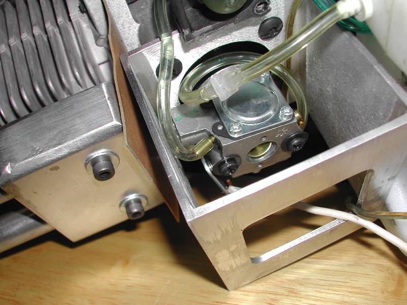

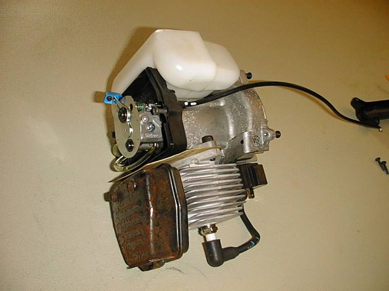

Thanks, I found it on Amazon. Sounds like a good book. Finally here are the pix I said I would post. This first post will be after I took all the weedwacker stuff off and then the next post will be after I temporarily put everything together to make sure it ran. If you want to see the first set of pix, check out the 1st page of this post.
#67
Joined: Jul 2005
Posts: 363
From: East Coast

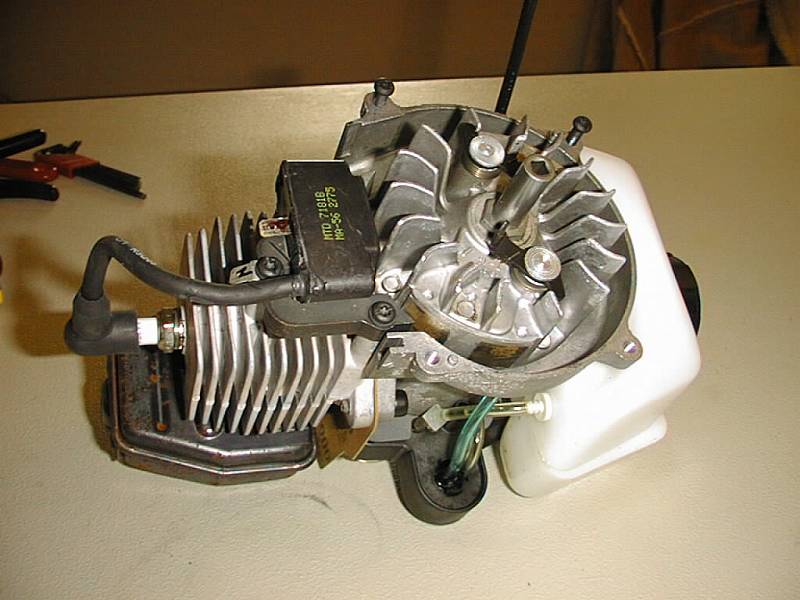

Now as I said, this is my first conversion so don't laugh too much. If there is something anyone sees that can be improved or that needs to still be cut off please let me know, I wasn't sure how much I could and shouldn't cut off so I tried playing it safe. I am open to any sugestions. I still need to cut the primer bulb off and I am going to paint the engine. I got Ford Red for the cylinder head and Black for the body. I had to take the pix in my bathroom as it started to leak gas so I ran it to the tub. Took the pix as quick as I could.
#68
Joined: Feb 2006
Posts: 186
From: clinton twp,
MI
SaCCaL72
not bad !I usually clip off the throttle spring where it wraps around the throttle arm so throttle is not spring loaded
but leave the rest of the spring in place for a spacer.
you could cut more off the front where shroud was,I square mine up even with the sides and cut the front flush with the receses in the front . kind of looks like an old cox 0.49 on steroides when i'm done.I'm pretty anal about weight though.
just square up the sides and thats probably good enough, remember were removing weight.weight is our enemy! just be carefull around where the jug and cyl. meet, in the front is very thin.

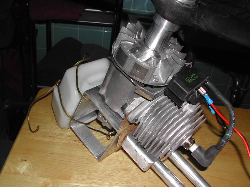

Thanks for your suggestions. Here are two pix I marked on, is this what you are talking about to cut off? Please see pix... Also, I did release the spring tension it is loose I just hadn't cut the hook of it off, I wasn't sure what to do with it, I will cut it off now, thanks...
#70
Looks like the fins on the flywheel could be cut back. Less weight and less air grab. Also engine box could be drilled out with a partern of small holes...again loosing weight. Then put a ignition like RCIGN1 has. Save more weight...no big flywheel. If that is not lite enough... go to glow/gas mix. Good Luck, Capt,n
#71
Joined: Feb 2006
Posts: 186
From: clinton twp,
MI
SaCCaL72
YEP,THATS THE STUFF,just go slow especialy in the front under the jug \crankcase conection its kind of thin in this area
a rule of thumb that I use even when building is that if I cant see what it does ,then, I dont need it .weight is the enemy.
behind the flywheel are four....I dont know, call them ,webs ,flanges whatever, these web's come from the shaft housing
and radiat back into the shroud that you have been cutting on, the top one ,ends at the mating flang for the jug\cylinder
conection.here I leave a little piece to support the gasket flange on the crank case all the rest I remove .it will only remove a little weight (like5 oz)and if your not comfortable doing it, then dont. like I said I'm pretty anal about some stuff weights one of 'em. but whats left of the shroud I would get rid of ,no danger there that'll save you 3-4oz easy .pop the flywheel, zip it off ,re-install front of engine ,done.and it gets rid of potential pinch points near the flywheel(saftey first ha,ha,ha)
the carb spring just ends up looking like a wound wire tube ,it keeps the butterfly in the carb properly aligned so that it doesnt get bound up.
pictures look good ,I need to get a cammera it would help to explain things easyer .otherwize looks good to me
