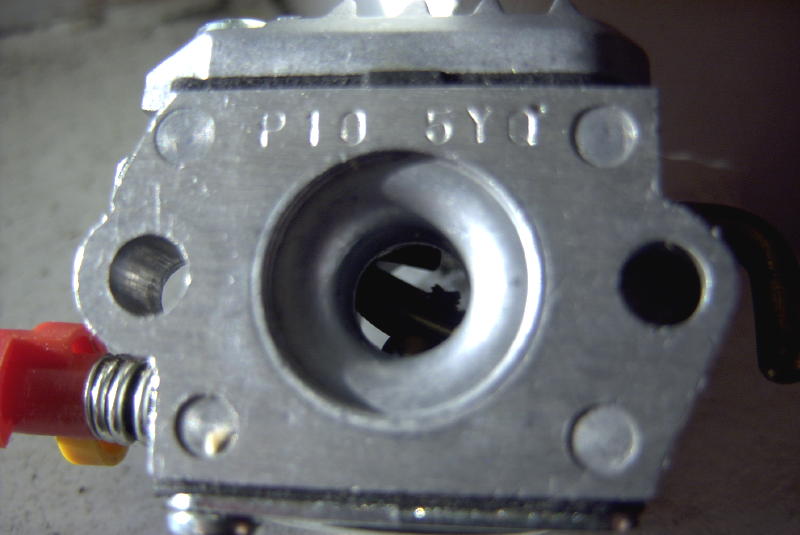

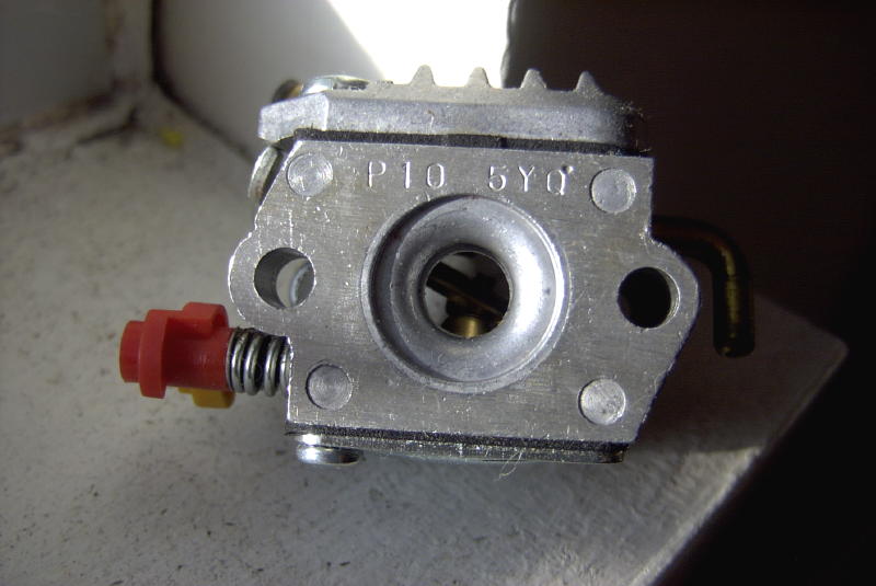

I have a Ryobi from my Son-In-Law's old string trimmer that I have had for a few years. it ran great when in the trimmer with the exception of the carb. The company bought him a new trimmer and I got the motor. I have the new flywheel cut and balanced, and the engine prety much set. I need to get a new carb for it though, and want to get a Walbro carb. Does anyone know a model number or size? I plan on putting this on a Great Planes Giant Big Stik. Thanks for all the help in advance. Here is a pic of the Zama,

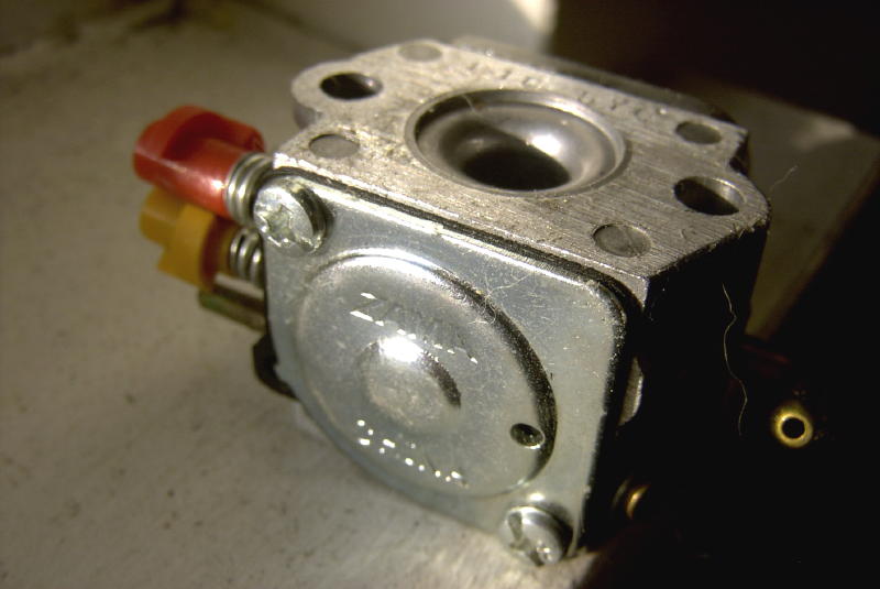

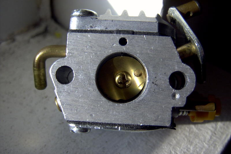

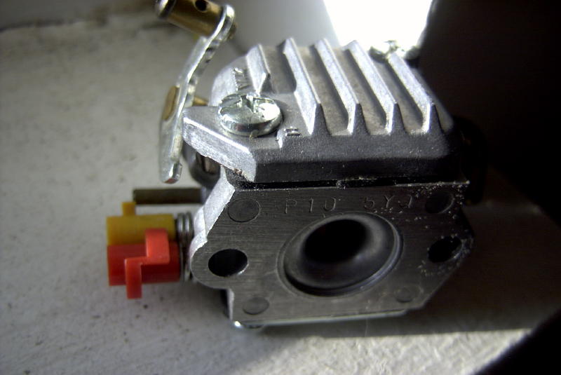

I have received and gone over the lists of carbs, both Zama and Walbro, but when looking for the carb that I have, I do not see it listed. I have seen other carbs, but what I belive to be the vent hole will not match up with the back plate. Here are some pics of my Zama and the back plate. Any ideas? Is that a vent hole that must match up with the carb? Just consider me new, and confused!

If you mount the carb with the pump part (The side the vent hole is on) towards the cylinder it will align perfectly.

The Zama carb on your Ryobi has a 5/16" venturi and in metric terms that is 8mm. All the carbs in the Zama and Walbro lists are 11mm or 7/16". This is the size you want to go to so you will have a good airplane engine.

Look up your carb here....
http://www.zamacarb.com/prodlist.html
The number shown on the mounting flange of your carb "P10 5Y0" is not the model number of the carb. The model number is on the side of the carb.

No wonder I couldn't find it anywhere! I do see "C1U on the side by the needle valves.
