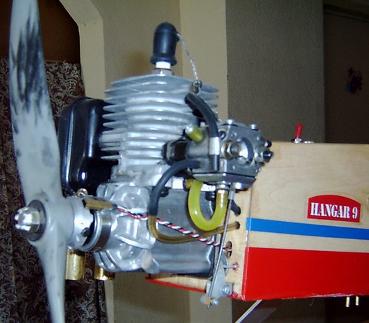

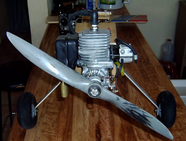

Old 02-12-2006 | 08:25 PM
av8tor1977's Avatar
Joined: May 2003
Posts: 7,245
Received 6 Likes on 5 Posts
From: Tucson, AZ
Default RE: homelite 30cc with CH ignition
All the little tricks. Porting, port timing, crankcase stuffed, compression increased, larger carb, free flowing muffler, electronic ignition with timing optimized, Frank Bowman rings, etc....
It should turn the same prop around 8500 or more with only minimal mods like a carb and free flowing muffler.
AV8TOR
ID:	407040   Click image for larger version
