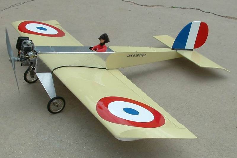

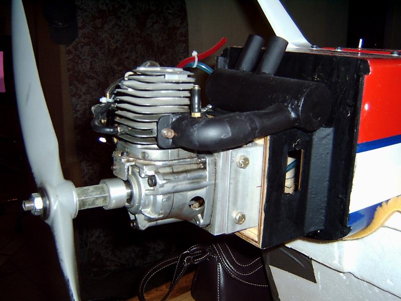

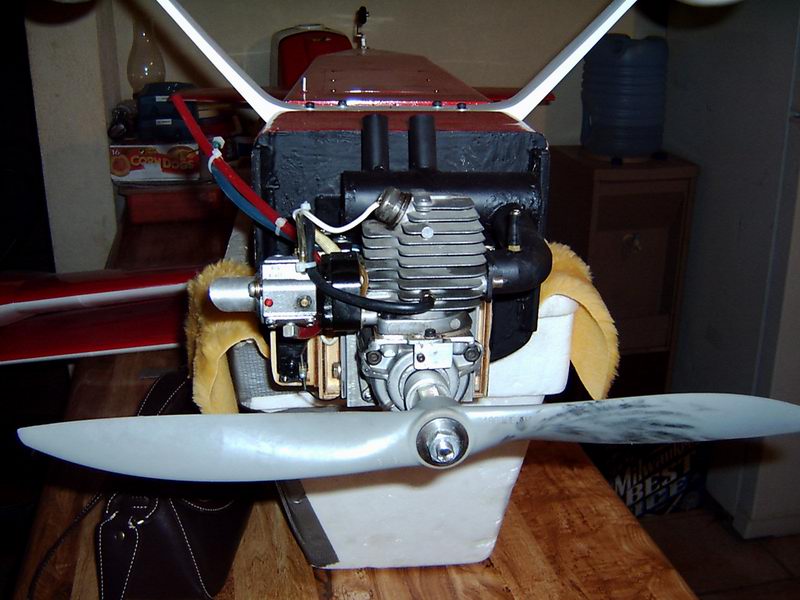

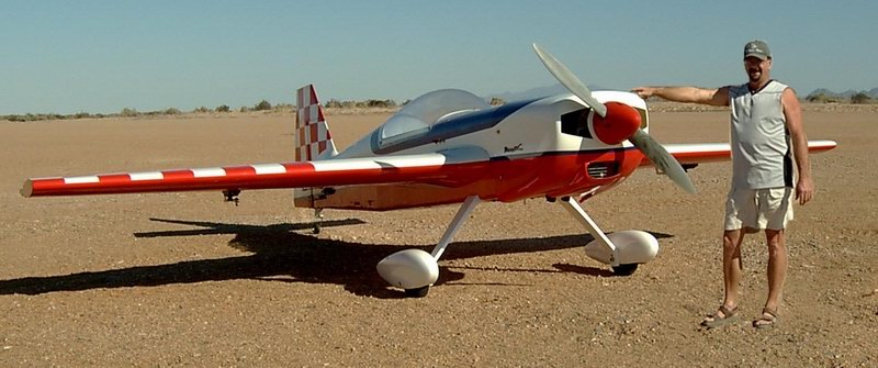

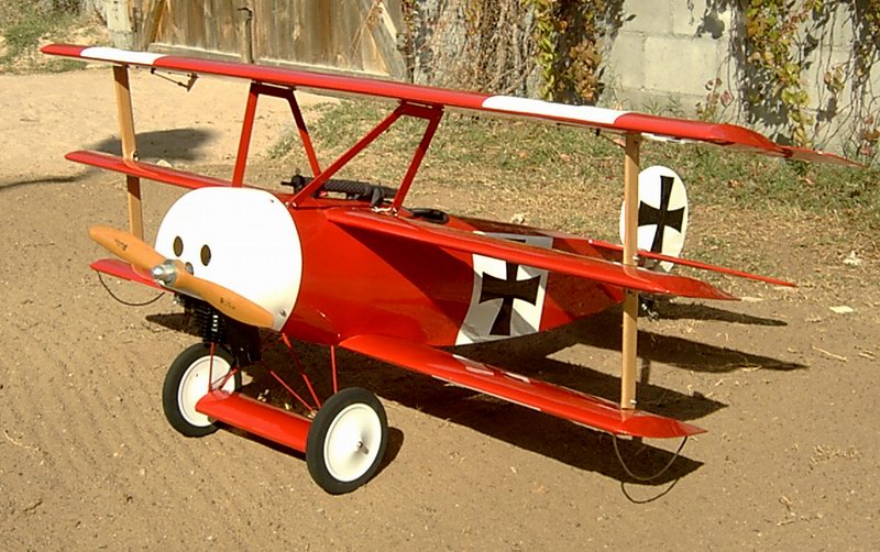

There are lots of planes that can use a good 25cc engine. Like I said in the earlier post; anything with about 1000 square inches of wing or more, and preferably weighing less than 13 lbs.
"PHOENIX" my own design. 10 lbs. 1000 square inches wing, Homelite 25cc
Giant Scale Planes "KATANA 72". 12 lbs. 992 square inches wing, Echo/Kioritz 23.6cc
Hangar 9 "ULTRA LITE STICK 120". 11.5 lbs. (with smoke system) 1150? square inches wing, Homelite 30cc
Great Planes "FOKKER TRIPLANE". 10 lbs. 1312 square inches wing, Echo/Kioritz 23.6cc
All are very aerobatic.
