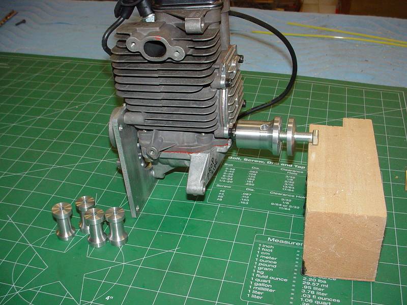

the stihl saws make good engines , jonesred also but some of the older ones are heavy, the 25.4 and 27 and such make good ones and are lght. here are a couple pics

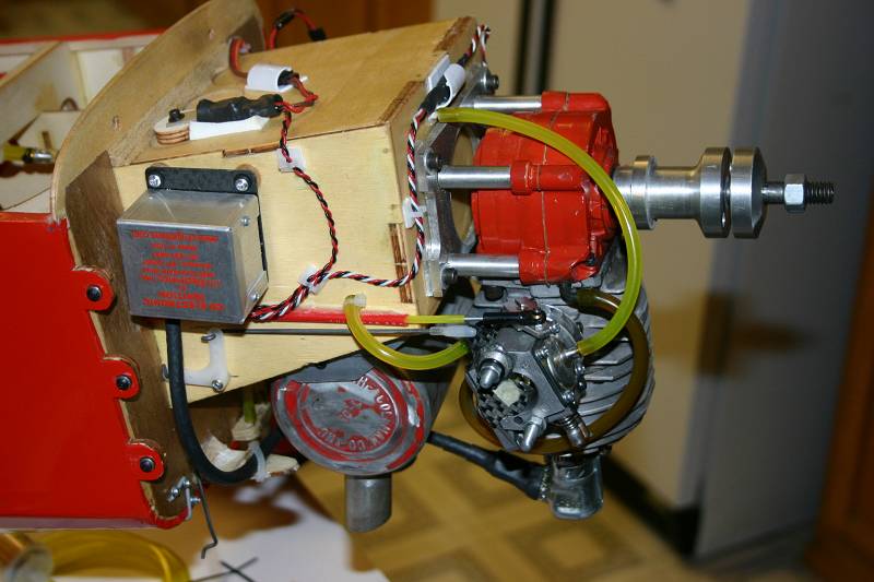

I have done one of the four mix and weight is a huge factor

the pic of the four cycle is a 69cc back pack engine ( four mix ) is weighed around 11 # ready to fly if I am not mistaken so the weight is an issue on the four mix engines even the ones on the back pacs blowers .

I converted a Stihl 031 50cc. There were 50 & 56cc versions. I got it to the same weight as a DA and on the same prop and tach it runs right with a friends DA in a side by side test. It flys an 84 inch, 16 pound extra very well. Some simple machine work can take alot of weight off these motors.

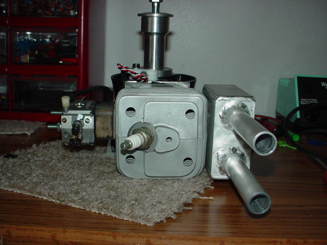

I will try this.

mark
details,details you must give us details!for instance c.c., is that a "tuned" pipe.I like what I see,clean, neat,simple

mark that looks a lot like a poulan 60cc with the gilrooni cylinder?

It's a Stihl 031 50cc. The muffler is simply a Coleman back packing fuel container with a couple of down tubes welded in and a end cap machined from aluminum. The muffler is very effective. I made the header from K&S pieces. The cylinder has Mahle cast into it. I machined the conversion parts, and turned down and thinned the cooling fins in my shop.

Mark: I got to hand it to you.....you done a very,very nice job. I got 3 chain saws...I think the Stihl is going to loose its saw parts....soon. Capt,n
