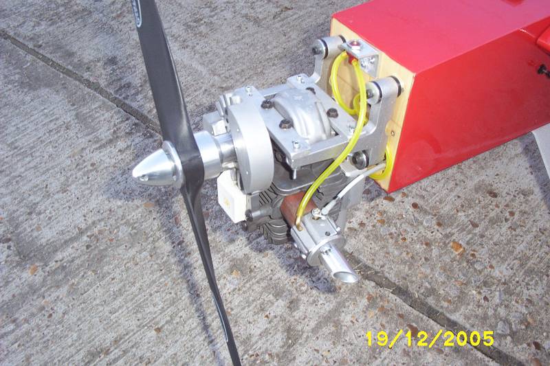

I got this engine from Scott Ellingson two years ago and just getting around to putting it on a plane. Ill be installing it on a GP giant stick. My question is what kind of motor mount should I use? If anyone out there is flying this engine how do you like it?

Dave you'll need a beam type engine mount like the one that Dubro's sells with vibration dampers or the one like H9 sells for 1/4 scale planes.
Use the aluminum kind I think that the plastic ones may break with the torke these engines develop.

I had this very engine installed on a GP Giant Big Stick and Scott told me to use the largest metal Du-Bro mount. I belive it is the one for 120 4 stoke engines. They are a little expensive, but will worth it. Makes the installation just like a glow engine and the shock absorbing is a nice feature. Take a look at the pic. I had trouble getting mine started and Scott took it back and I upgraded to a 42cc w/ei I plan on using on the giant big stick. You will need a starter that spins this engine at least 1000rpm to get it started, but once it is started you'll love the power it has.
