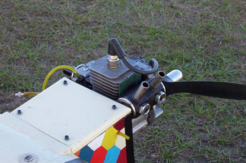

My plane (Bridie Stick) with a Homelight 30 has two 422's on the elevator and one on the rudder.
The rest of the servos are Futaba 3004's
I'm just a sport flyer. Plane seems to do just fine.
Enjoy,
Jim

I also have a Robinhood 80 with all standard servos with just one on the elevator. But it has a OS 91 Surpass glow engine.
ID:	436434   Click image for larger version
ID:	436435   Click image for larger version
ID:	436436   Click image for larger version
