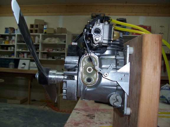

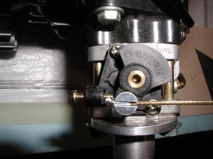

You guys that have converted GX31's: Did you modify the throttle configuration on the carb? I'm wondering if there is anything I can do to avoid using a high torque servo for this linkage. The existing lever requires quite a lot of force to open...and then is spring loaded on the return. Should I change anything or just set up a bellcrank linkage to a high torque servo? I'm new at this and would appreciate your voices of experience. Thanks!

I have looked at several carb alternatives for mine. However, I decided to make a new intake manifold and use a WT type carb. Took the engine completely apart to clean it and see what makes it tick. While apart I drilled and tapped a spot in the block for a pulse tap to the WT carb. Just turning by hand produces good pulse. Got the idea from a guy that uses these in boats turning over 10000 RPM. He claims no problems with this setup. If this does not work for me I will just plug the hole and make a manifold to rotate the WY carb. Found several with high needles and 10.5mm venturi. All I need to do is weld the header pipe I just made to the flange and time the engine. As mine sits it is at 4 pounds.

I removed the barrel and clipped the return spring about 3/4 of the way or so and removed the top part with the hook on it. Now it has enough pressure to keep the barrel under tension so it raised the needle but not enough to provide any real resistance to the servo.

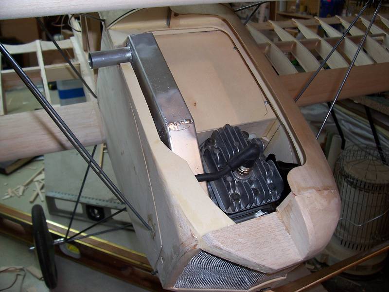

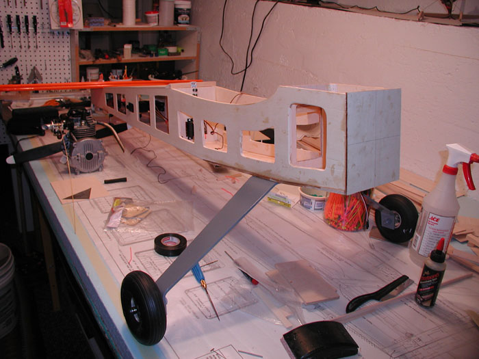

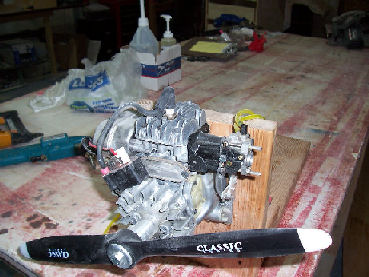

We ran the Briggs (Not the imperial We, but a friend and I) yesterday for about three hours inverted. There were no ill effects.
The only issue that we had was with running the carb upside down we got poor performace, mount the carb (only the carb, not the engine) right side up and it performed great. I would really like to have a carb that I can adjust both the low and the high, the Brillelli (thanks Tim) carb was just too big to get it to run well.
The Briggs is 8.5 inches from the bottom to the top of the spark plug boot. From the center of the prop spacer to the top of spark plug boot is 6 1/4 inches. I am looking at the plans for my Sopwith Pup, the firewall at the cowl is 9 inches in diamater, so the engine, if mounted inverted would stick out the bottom of the cowl approximently 1 3/4 inches. I would need to cut a large hole in the bottom of the cowl to fit a Briggs. I dont know the specs on the honda, is it shorter? The sparkplug and boot are about 1 1/2 inches tall above the head so even though I would need to cut a large hole, the jug wouldnt show much from the side.
I used a turnbuckle to hook up the throttle, and I did cut the spring down so it only keeps tention on the barrel and slides easy.
The Fokker DVII is 21lbs with the Briggs and Stratton and the Pup is 12lbs with a Featherlite 25cc. Here are some pictures of the Briggs and Stratton engine, we made the custom exhaust so it would exit about the same place as the dummy engine header was.
