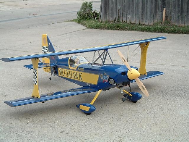

What Ulimate are you going to use? The CG Ultimate has 54" span and 980 square inches area. One of the guys put a homelite 25 in one. It is a four pound motor. A trimmer engine has a poor power to weight ratio, so it can't be considered high performance. Most of the best performers use electronic ignition to save weight. I plan to put a Mac 21cc on EI in my CG Ultimate. It should come out at 1.5 pounds per square foot for a ten pound airplane. You can do a search for the Homey powered Ultimate in the conversion forum. Here is a picture of it.

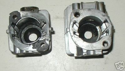

I have a Poulan 25cc from a leaf blower and I can tell you the engine has very good potential. The exhaust is extremely restrictive because the exhaust port has a lip on the I.D. that
reduces the effective area by 50%. With the stock porting, carb and muffer, the engine tacked only 6600RPM with a MAS 16-8 Classic prop. I added a Tatone muffler, a larger carb and
removed the internal lip in the exhaust port (I filed it open to match the rest of the exhaust port) and the RPM jumped to over 8000. There is room to open the exhaust port a bit more, plus you can open the intake port (it narrows down from the outside of the cylinder where it mates to the carb heat isolator, to a smaller opening as it enters the cylinder. File it open to be uniform in diameter the whole length. An even larger carb than I used could be added and. I'll bet the engine could get close to 9000 RPM with the 16-8 prop after it is broken in.

I just got finished doing a 25cc Poulan, do you have any pictures to show what you did to the exhaust port?

Remove the muffler and look into the exhaust. The internal lip will be very obvious. It completely circles the inside of the port. Just carefully file the lip away. File until you open it up the the surrounding port sides. Do not raise or lower the main port passage way...only opening it up by removing the lip.

My exhaust port is tapered but does not seem to have any type of lip. The bottom of the port is level with the top of the piston with the piston all the way down. No lip.
It's hard to see in these pictures but here are two with piston up and piston down.

It looks like you got the high performance model. With the lip the exhust opens at about 60 degrees before bottom dead center. without the lip it opens at about 70 degrees BBDC. You also get the large transfer passages and intake. My 25cc has a 10mm Zama carb, which is fine.

I just measured as best as I could with a protractor and a flash light. It is pretty much exactly 70 deg before bottom dead center. I need to get a prop on it in the next few days and see how it runs.
