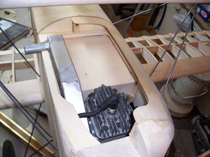

Old 12-03-2006 | 01:00 PM
  #75
jtisch's Avatar
Joined: Apr 2005
Posts: 749
From: Federal Way WA
Default RE: Another Brillelli Masterpiece - Briggs 34cc Four Stroke
Here is the 40cc in its future home.
J
