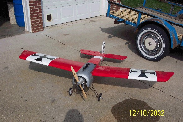

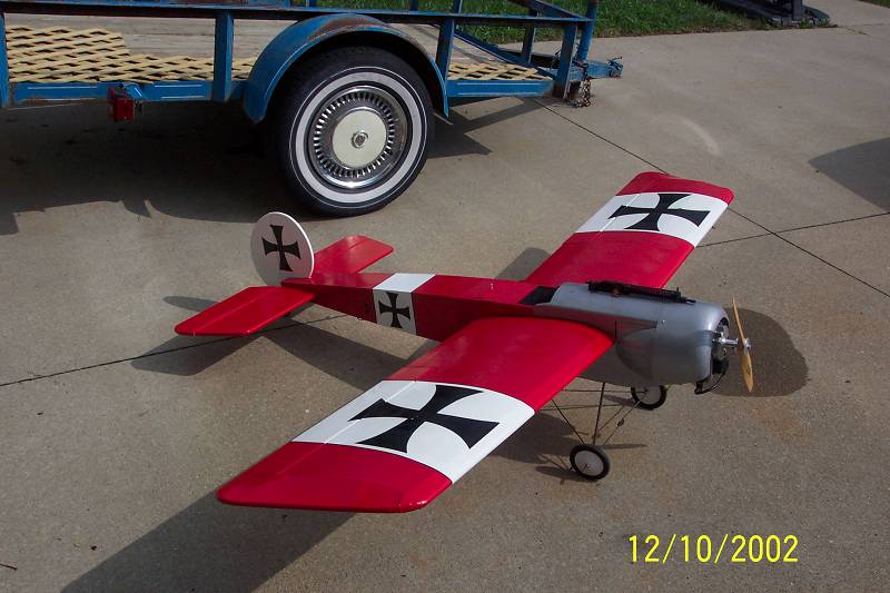

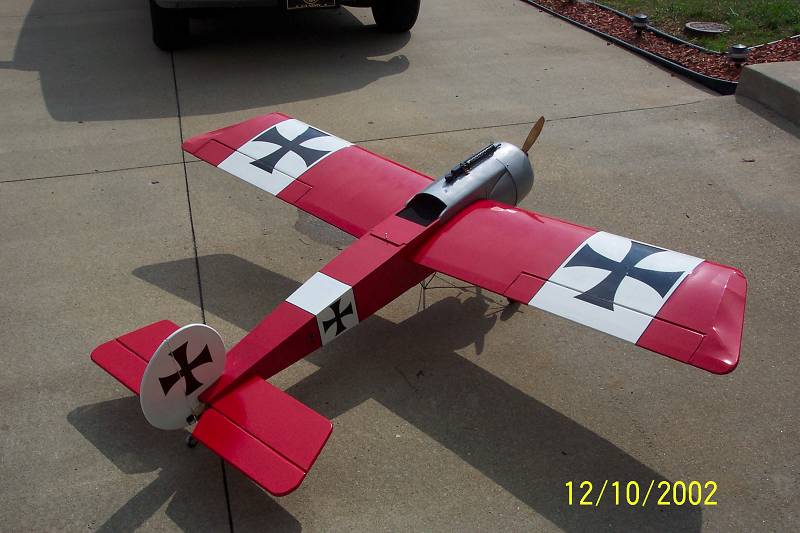

THis is the BP Hobbies Eindecker, before I added wheels, and other details.
Billrad

Old 12-11-2006, 11:34 AM
  #81
Prop Nut
Prop Nut's Avatar
Join Date: May 2004
Location: Coral, MI
Posts: 1,752
Default RE: Another Brillelli Masterpiece - Briggs 34cc Four Stroke
You can mount the Briggs inverted (I have it inverted on my 1/4 scale Fokker DVIII)
It takes straight gas.
A small mill/lathe combo would be perfect for making the conversion parts. (all you reallyl need is the prop spacer, the motor mount can be made with a bandsaw and a drill press. A mill would do a nicer job though.)
The conversion is really easy. A straight pipe would be perfect for the exhaust.
