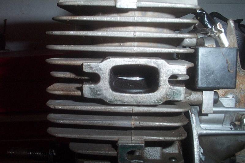

Old 11-01-2006 | 11:17 AM
andernamen's Avatar
Joined: Sep 2005
Posts: 484
From: Norfolk, VA
Default RE: Homey 45 - What Saws?
Here is my Homey 45 taken from an older one with the black cover. Note the exhaust side - no threads! Arrgh!! How can I remedy this.[img][/img]
Old 11-01-2006 | 04:11 PM
My Feedback: (29)
Joined: Jan 2005
Posts: 1,402
From: San Antonio, TX
andernamen,
This is a great arangement. Use the original 10x32 bolts with locknuts or trim down the head of any pan or button head bolt to fit in the slot. No more stripped threads or lost mufflers. Locknuts stay put without locktite or lock washers. Isn't the famous G62 like this?
