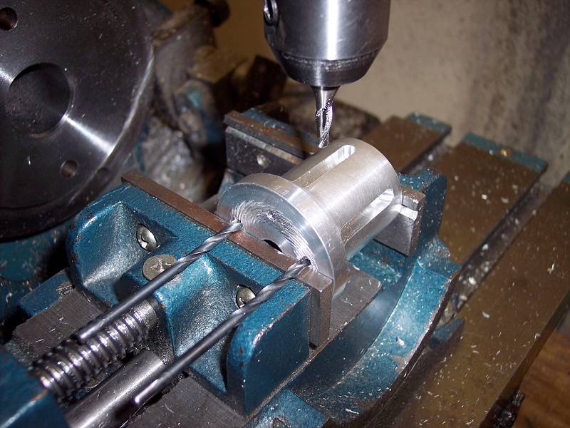

Nice looking prop hub. What are the 6 (?) holes for on the rear surface (toward the engine) of the hub?

flipflop: Nice work! What knurling tool did you use on face of adapter. Thanks Capt,n

The six holes are drilled with the hub mounted to my rotary table. They are used to "index" the hub while I'm machining the slots in the hub.

Another way to make 4 grooves...Drill a prop bolt hole exactly in the middle of a 2" square block. Put the prop hub on the engine...Bolt the square block on the end of the hub...Clamp the hub in your mill vise, use a 1/2" ball end mill to make grooves in the hub...

Even another way or two is to use hex or square collet blocks. leave just enough material on one end or the other of the hub, insert it in the collet block and clamp it in the vise. use a machinists jack under the hub for support. Mill a slot and turn or index the block. Have also done the same thing with my Yuasa spin indexer.
