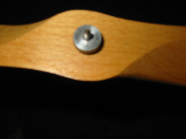

For you guys that have a lathe...you can balance flywheels with this set-up. Just a tiny metal shim or screw and it rotates right to the bottom position....fast. I am using a small prop balancer that has cones for centering. Capt,n

Cap can you give more detail on this balance setup??

tstotts: I have a device that I picked up years ago to balance props. I thought I would make a couple of shafts with a very small center in them so I could use them to support the sharp tapered end of the balance center that has 2 cones on it to center prop. I found I could adjust the tailstock just right and get a very sensitive balance on props of about 18 size. Its nothing magic...but it works!!! Capt,n

Thanks Cap the set up is simple enough the way you explained it. wind is supposed to be good for flying tomorrow so going to get some run time on the Thor today and do a lot of range checks in hopes of flying tomorrow.
