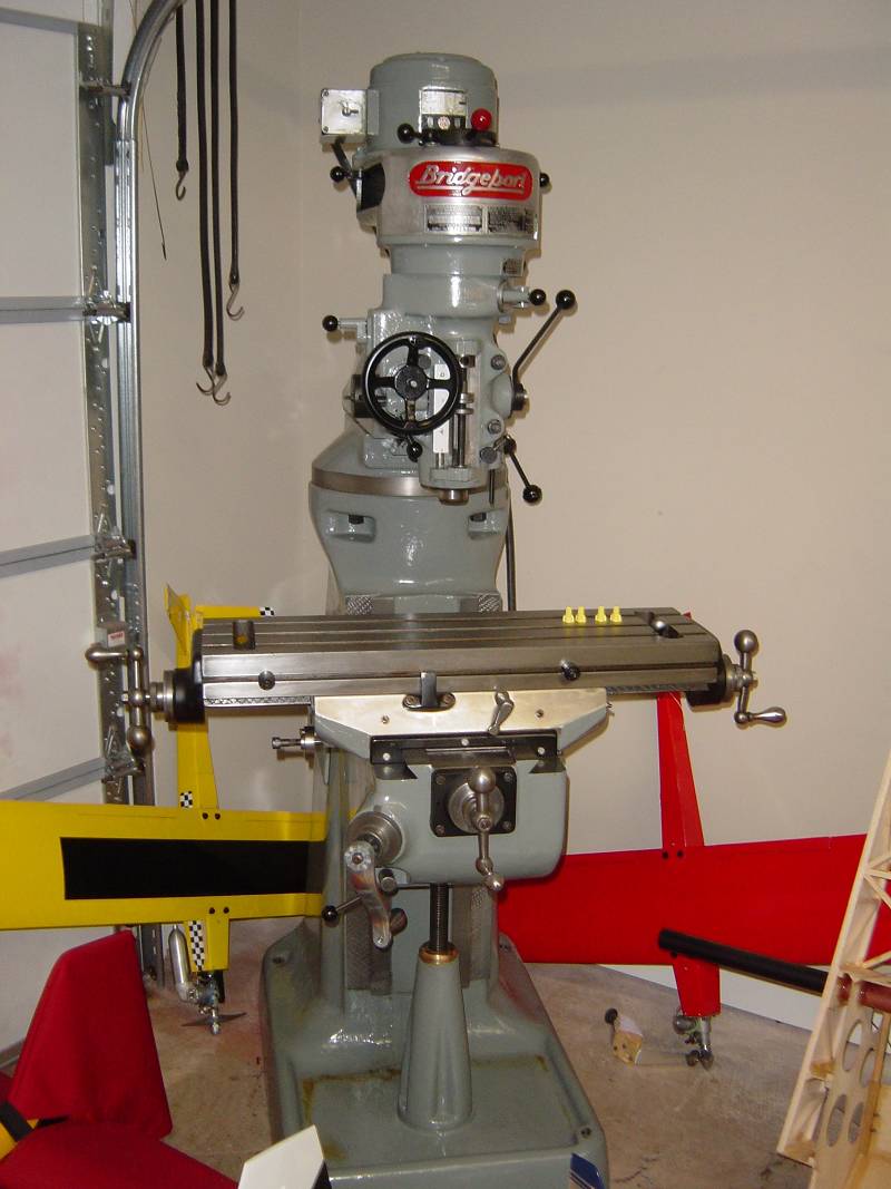

Tim, that is what I am quickly finding out, and I just got into this machining thing. I benefitted from having a good friend who's a serious home machinist. I took his advice of leveling the surface of a good solid workbench before bolting the lathe down on the tabletop. I then checked for any remaining warpage by lightly turning a long drill rod with a sharp bit. Mine turned out better than my 0.001" mic can measure, so no fine adjustment was necessary. It really emphasized that there is no substitute for cast iron, which made me glad I went with the 8x14. It is ready to go right out of the box and a lot of cast iron for the money.
Right now I'm working out of my garage, so the 8x14 will be it. Once I get my workshop built this winter, I'm getting larger machines. Still, it's a good exercise to cut my teeth (maybe literally!) with the small machine. They aren't as intimidating for a rank beginner and, missing features found on larger machines, simpler to operate.
BTW, it's funning seeing your little quickie 500s sitting around the big ol' BP.

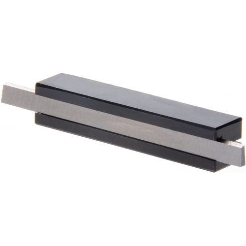

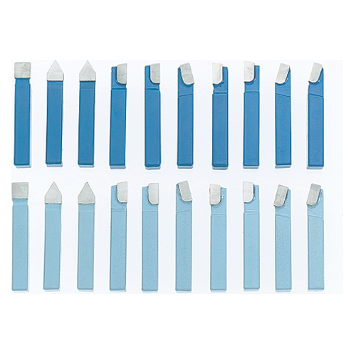

I am about to purchase some Lahe tools for my 8x12/14 lathe. I will post some photos below. If anyone can give me some good ideas...please do. Thanks Capt,n
#72
Get some plain old HSS tool bits and learn how to grind them. IMHO, they give a better finish on most metals compaired to Carbide. Espically on small lathes. Of course, I havnen't taken the time to setup corectly for Carbide. I know they like faster cutting speeds and deeper cuts. Production cuts. For most of the work we'll do on small items like engine parts, a properly ground HSS tool bit will give much better performance. Where you need a Carbide took, you realy need it. Few and far inbetween though for light work. One thing you will have trouble doing is dusting off a thousands with a carbide bit. Easy with a HSS though.
Get a good cut off tool, again HSS, and read up on setting it up. Nothing like ripping a piece of work out of the chuck to wish you had set up the tool correctly. It's not hard, but it's one of those things that thre is the right way, and anything else just won't work.
A good QCTP is great, but nothing like an old lantern post with a rocker for getting into the hard places. Like most things each has it's place.
