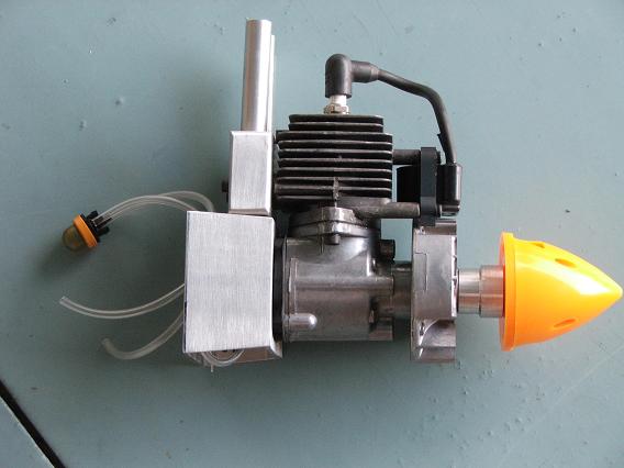

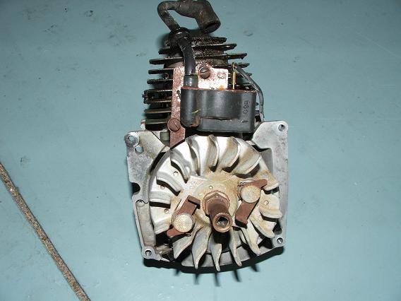

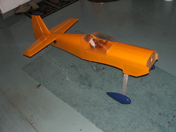

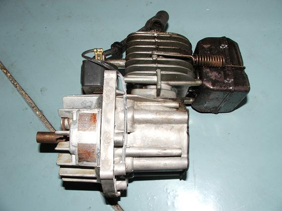

Okay guys, tonight I finished my conversion! I cut down the choke and mounted it, and it works great! My next step is mounting the thing to the fuse of my plane. I have included some pictures in this order:
1.My Ryobi
2.Ryobi again
3.Cap 231EX fuse
4.Model number of the other engine I recieved recently
5.The fuel tubing I am using, dont know what type it is...
6.Engine, dont know what it is, any ideas?
7.Engine again
8.Again...
9.Again...
And thats it for now! I should be able to mount it this weekend, but I need to buy a bigger fuel tank, 8oz isnt going to cut it, Im thinking 24oz.
Colin C

I have two Ryobis mounted with 16oz tanks. That amount of fuel will run engine for well over 20 minutes with a reserve to spare. I chose use the space inside fuse for other things and saved having to carry around that extra fuel weight.
Sorta like trimming off the extra metal weight off engine.
Did you open up the reed valve limiter abit to about 1/8" allen wrench thickness?

If you mean that little flap on the backplate then yes I did.
I know, 24 does seem a little much, maybe Ill go smaller, like a 16 if your saying that will give me 20 minutes flying time.
Anyways, anybody know what type of engine that is yet??
