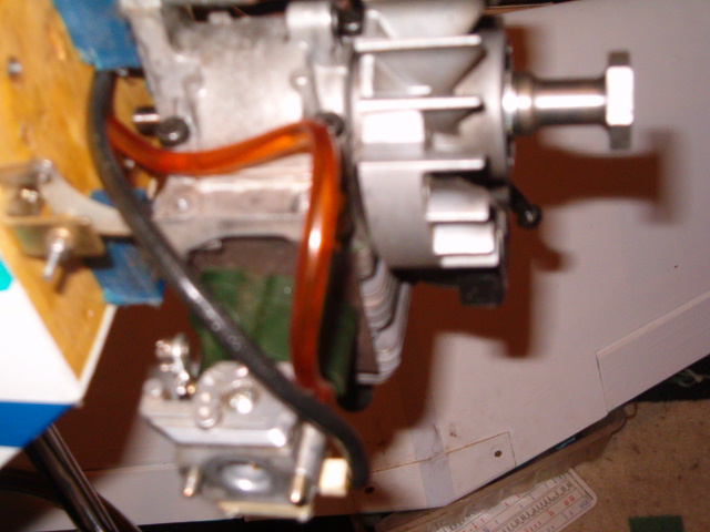

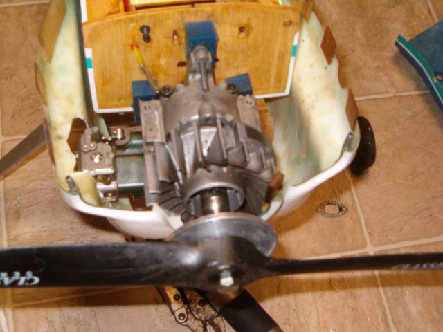

one was a test fit.

Old 01-09-2007 | 10:21 PM

no i just converted it, i just finished a 3.3 but its reed valve i dont know how i feel about it. why do you ask?

The prop hub looks like a steel one like on a Zennoah. How is the compression and does it hand start easy? Capt,n

my father in law made the adapter for me from a sketch i gave him, compression its 2 ring engine has 3 hours of weedwacking compression is really good hand starting is a yes, but it does take some butt behind it to hand start does it look ok to you guys im going to get another muffler for it but if you guys don think its enough i may think about putting it on the showtime

Looks like a good conversion. Like you say a different exhaust may be needed. May give it more power too. How much does your showtime weigh? Also the wing area. Its a good idea to figure wing loading. Capt,n

well i flew the cap today it flew well had good power for normal aerobatics not a chance in the world on hovering or vertical pulls it weighs in at 13 lbs even going to leave it in there to have a great conversation piece, going to convert another and stick it in another plane thanks for everyones input any questions on the conversion ill try to help
