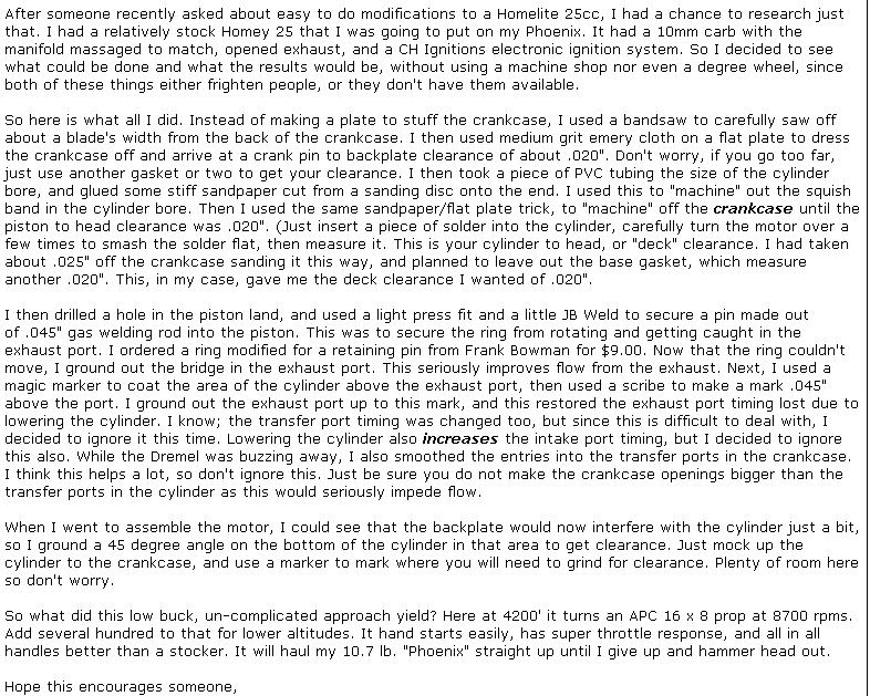

From the picture in your first post, it looks to me like your motor has already been ported. Put a degree wheel on it and find out exactly what you have.
http://testfly.0catch.com/homelite/e...lindermod.html

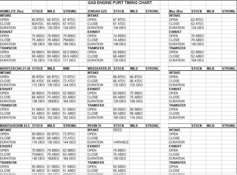

Here are a couple port timing charts and one very good article from a much earlier post that may be of interest......Bob

AV8TOR, what post did that chart come from. For some reason when I went to save it as a JPEG it gets blurry, or is it my eyes that are going ?????
#49
ALW Phatom: When you bring up the chart...just single click on it and it shoud be easy to read. Its kinda strange...but it works for me!!!!!!!!!!!! Capt,n P.S. Use the Home key and end key on keyboard to get to the begining or ending of a long post.
