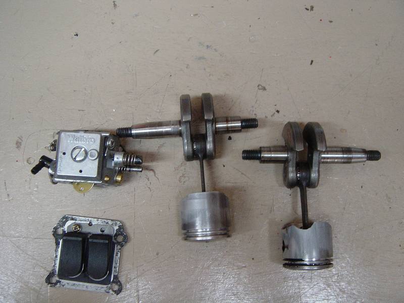

Default RE: Echo BME twin

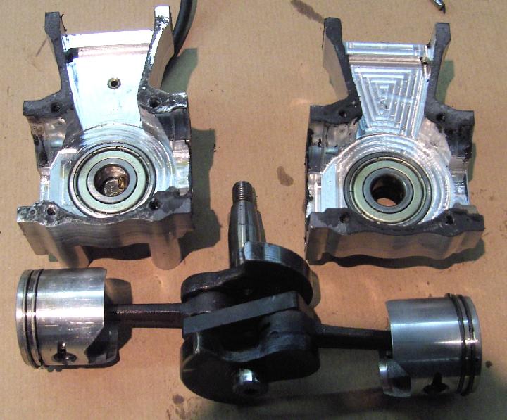

Hey Capt,n I have two cases comming from Keith. The crank is easy now that I talked to him. Cut one end of a crank off flush with the counter weight. Bore a hole into the counter wieght to accept the other cranks end. Cut another crank down so that you allow for and have a flush fit when pressing that nub into the bored hole in the crank. Line up the cranks so that you are opposed 180 degrees and both rods will be at TDC at the same time. The counter weights are ground flat so when you pair them up all you need to do is tack weld them together in a couple areas. I will figure some way to make a jig or some setup to indicate them in as close as possible. Keith indicated to me that if you were off a bit it will not make a difference. I may for safety sake drill the front journal area and pin it. Keith said there were some that would walk and get out of line when welded. My welder friend said he can do the tig welding no problem and keep heat to a minimum too. I may have to try this before I tear down my machines to move them to my new house and shop. We will see. I am trying to finish assembling my new Carden 35% Edge now before I move. A few more nights wiring and a little time with the spray gun and I will be set. Maybe!!

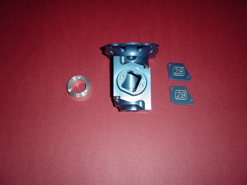

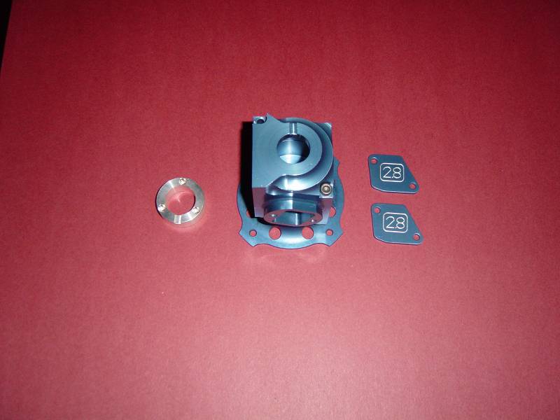

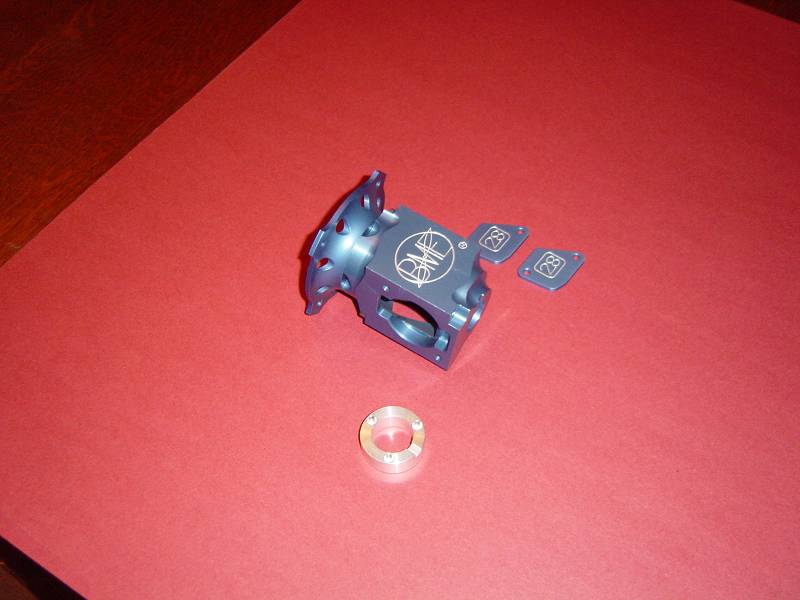

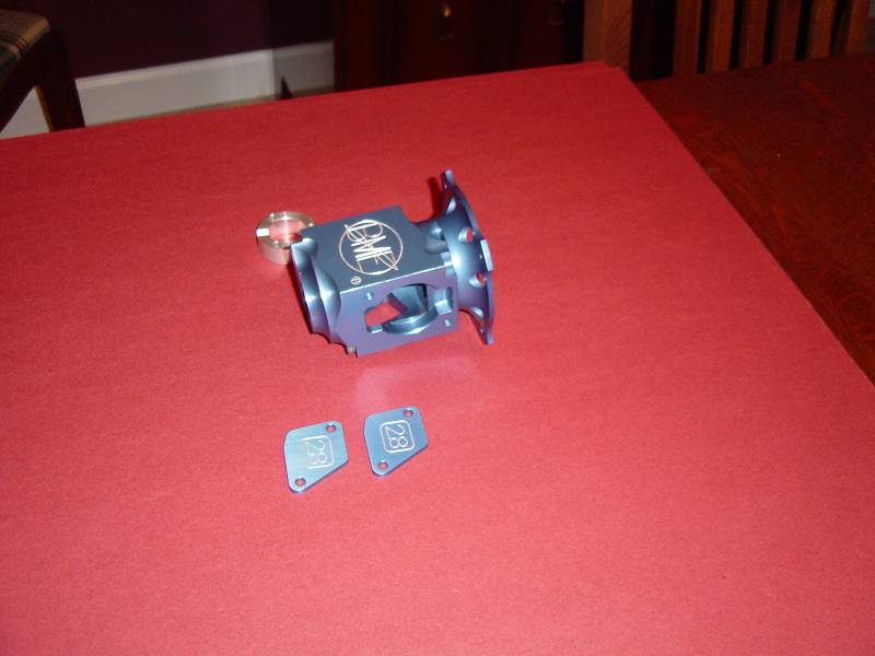

Her you go guys. Got the cases and other parts today. Look real nice. When the time comes I think I can shave a little weight off the top of the case. We shall see. I would like to remove the anodizing too. I may try the bead blast cabinet and see what it brings me as I prefer the plain aluminum look. Otherwise these things are outstanding. Thanks to Keith for making them available to us. Will try to post the weight later.

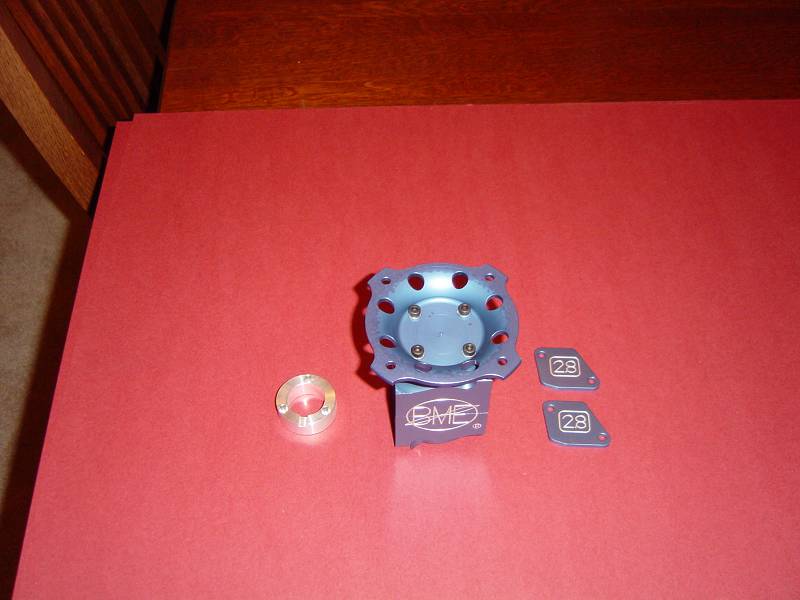

tim220225: I do not see a split line. Does the crank install from the rear? Is the bushing for endplay? Thanks Capt,n
Old 02-22-2007 | 09:42 PM
tim220225's Avatar
Joined: Jan 2004
Posts: 1,005
From: Mobile, AL
There is a split line, very well hidden with the fine CNC machining.Where the BME logo is there is a prop outline and the split cuts right through the center of the prop. The crank works the same as anything else for installation. Exception being the rear bearing presses in from the inside like always but no seal is needed as the crank stub for the clutch gets cut shorter. The other unanodized piece goes over a third bearing that installs on the crank after the crank is installed. Slide the bearing on then the piece of aluminum and drill and tap the three holes to hold the bearing block in place. The milled slot is for the timing sensor to glue to. Now I wish I could come up with one or two cases like these for the 61cc twins I have here.

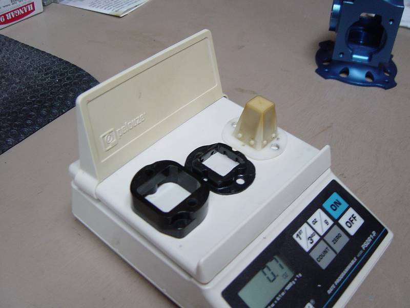

Well I just weighed the case and it comes in at 11.7 ounces. The reed assembly weighs .7 ounces less gaskets. Here are two pictures showing the 3 pieces that make up the reed assembly, and another showing it assembled. The black spacer could be machined if need be.
There really isn't that much material there once you cut the shaft and bore the hole. Once you chuck the crank and indicate it in you should have a pretty rigid setup. I would chuck the hub end and cut off the clutch side. Plenty to grip to there on the hub end. Center drill the crank and go. Your hole will be rather shallow as I can see it. I looked at a crank I had here for reference. Before I did any of this I would rework the hub end to rid the crank of the LH threads. Don't know of any crank pictures out there yet. I think Huey-pilot will be closer than anyone. Wouldn't it be great if we all lived close by and could see things first hand? Here is a picture of two cranks I sent to Av8tor a while back. Maybe these being next to each other will help. Visuals always do for me. I think both you and foamcut can do it, just dig in.
Capt,n it will look somewhat similar. Ours will have four counterweights and no steel bar between them. That engine appears to me as though it would run kind of rough and be unbalanced. The counterweights on ours will be 180 degrees opposed. Look back at my crank picture and you will see what I mean. The crank on the left will have the clutch end cut flush and faced to the journal then bored. I plan on boring a flat bottom hole. I suppose you could bore through too. Wouldn't make a difference and be a little easier to do. The other crank will have one end cut off and faced to the depth of the hole. They should fit together nicely as the journals are ground flat. Align them and tack weld them together. Most of the stress will be on the front half or prop side of the completed crank so I assume that is the reason for the external third bearing.
