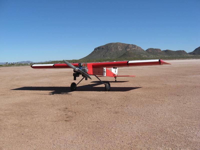

Old 12-24-2007 | 07:06 PM
  #264
av8tor1977's Avatar
Joined: May 2003
Posts: 7,245
Received 6 Likes on 5 Posts
From: Tucson, AZ
Default RE: Echo BME twin
Happy Holidays!!
Just got back from flying the "Echo Twin/Giant Stik" combo again. But this time I had my new camera to take some pics!! (Sorry, I was alone so no flight shots....)
What a sweet little engine. I really enjoy it.
I know Captain is going to jump in here and ask, so....
1. Yes, it is Gas/Glow
2. Yes, I have hooked up an onboard glow system.
3. No, I don't use it after starting the engine. Turn the switch on, start the engine, turn the switch off, go fly. Period.
Merry Christmas!!
AV8TOR

Old 12-25-2007 | 12:57 AM
  #265
Ralphbf's Avatar
My Feedback: (27)
Joined: Mar 2004
Posts: 1,450
From: Woodland, CA
Nice really nice.
What batterys are you using for the on board glow system?
Did you have to add any weight? If so where?
Old 12-25-2007 | 04:18 AM
  #266
av8tor1977's Avatar
Joined: May 2003
Posts: 7,245
From: Tucson, AZ
Thanks!
No, amazingly enough, the twin with it's mount, prop adapter, etc. weighed within one ounce of the Poulan 42cc single and mount that had been on the plane. It even has a smoke pump and tank in the front compartment too. With only heavy duty servos mounted in the rear, it balances just a touch aft of the c.g. specified in the manual. I do have the flight pack mounted towards the rear of the radio compartment under the wing though. The gas tank and the onboard glow battery are mounted right about on the c.g. I am using a 4500 mah onboard glow battery. Like I said, it is not needed for anything more than start up, but it is nice to not have to fool with hooking and unhooking two glow connectors. The plane flies so nice and light it doesn't even notice the slight additional weight. It lands very slow and light, and I don't use flaps. I had originally built it with flaps, but they weren't really needed and I found myself wanting a faster roll rate, so I took out the flap servos and hooked the flaps and ailerons together for full span ailerons. It's my favorite "knock around plane" now.
AV8TOR
